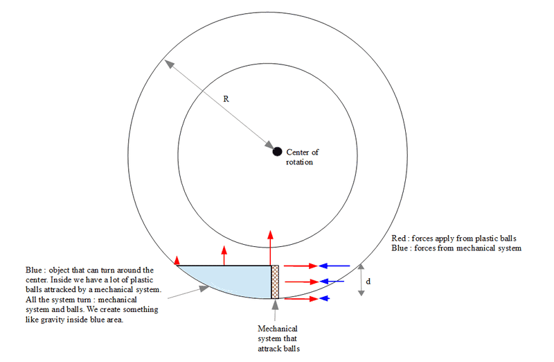

Hi,
I would like to calculate the sum of momentum in the blue volume. See drawing. The blue volume is full of plastic balls and a mechanical system attrack balls for have the same force like gravity. Like balls are attracks by mechanical system, the mechanical system is attracted from balls. We have forces from balls in red color and force from mechanical system in blue color. For me the torque is like:
M=P*pr* \bigg( \LARGE \int_{R-d}^{R}\normalsize\frac{x*(R-x)}{d}*dx + \LARGE\int_{R-d}^{R}\normalsize\frac{x*\sqrt{R^2-x^2}}{\sqrt{R^2-(R-d)^2}}*dx - \LARGE\int_{R-d}^{R}\normalsize x*dx \bigg)
With a numerical application, we have:
R=100
d=1
M = -24.83-66.32+99.5 = 8.35 P*Pr
Not zero, could you help me to find the error ?
Where do those upwards forces come from? In addition, I would expect that the horizontal forces cancel each other.
However, I don't really understand your setup. What is attracted to what, in which way?
The mechanism attrack balls and of course balls attrack mechanism.

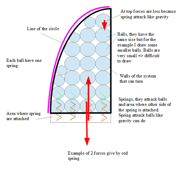

Ah, that is an additional wall. And we have many springs, connected to each ball.
So each element of the barrier at distance x from the center has a "ball stack" of height ##\sqrt{R^2-x^2}##, and the force is proportional to that? That assumes perfect stacks, especially no sidewards forces. I think this should give your second integral, but I don't see where the denominator comes from. Why do you divide that by the area between those drawn circles?
Anyway: The balls exert the same pressure on the barrier, giving exactly the opposite force and both contributions cancel.
Assuming your balls are not stacked in some special way, it is better to treat the balls as a fluid. You get the same pressure everywhere on the barrier, it is proportional to ##\sqrt{R^2-d^2}## and I will drop the constant here (it is the same everywhere). In addition, define ##s=\sqrt{R^2-d^2}##
Now, that integral becomes $$\int_{R-d}^R sx~dx = \frac{1}{2} s \left(R^2 - (R-d)^2\right)~~~ \text{pressure balls->barrier}$$

What is left? The forces of the springs on the wall.
$$\int_{R-d}^{R} \sqrt{R^2-x^2}~x~dx = [-\frac{1}{3}(R^2-x^2)^{3/2}]_{R-d}^{R} = \frac{1}{3}\left(R^2-(R-d)^2\right)^{3/2} ~~~ \text{springs}$$
And if you add all contributions, the result is 0.

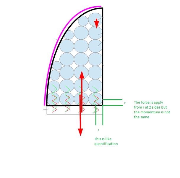

Edit: Ok, I understood the problem, it's because the radius change the position of the force. And now, I have another question: with small balls with r radius, the position of the application of the force is not the same (momentum) at the small side than bigger side (see drawing) so how this change the sum of momentum ?
I have drawn a simple ball with forces, for me Fv give momentum so how Fc can done a reverse momentum ?

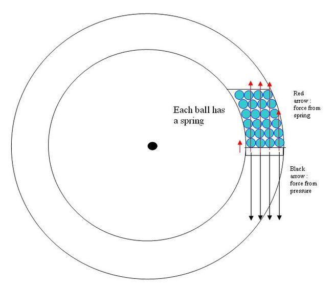

I have thinking about my problem and maybe I find an example easier to understand. It's the same system we have calculate sum of momentum. With a little modification on a placement of a ball, the momentum from springs don't change, the momentum to right side don't change but I don't know how the momentum which must be at R1 could be at the same momentum with R2 and R3 ?
The force would be transferred to the other ball(s) (and maybe friction), the result stays the same - it has to be, as the ball does not accelerate.
Ok, thanks. I forget the balls interract too... sorry

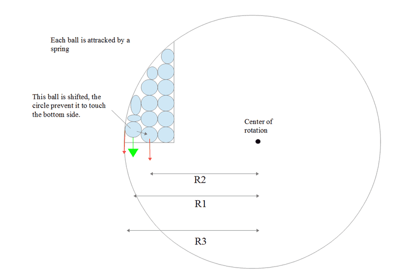

For this new case it's the same thing, balls interact for equilibrate momentum from red forces and black forces ? For me red momentum is less than black momentum due to the difference of the radius, so balls must change the force, could you explain a little please ?
With R2=big radius, R1=small radius, h=height of balls.
I have calculate only the difference, because a great part of the momentum cancel itself by logical.
$$+\int_{R_2 cos(asin(\frac{h}{R_2}))}^{R2} x dx ~~~~\text{from bottom pressure}$$
$$-\int_{R_2 cos(asin(\frac{h}{R_2}))}^{R2} x \frac{\sqrt{R_2^2-x^2}} {h} dx ~~~~ \text{from springs near R2}$$
$$-\int_{R_1cos(asin(\frac{h}{R_1}))}^{R1} x \frac{h-\sqrt{R_1^2-x^2}} {h} dx ~~~~\text{from springs near R1}$$
Ok, it's 0 but I will try with attraction like 1/d and 1/d² for show if it's always 0
