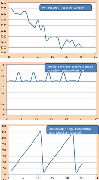

Hi, sophiecentaur
I just did the integration of Angular speed only...
As I said earlier, I receive the angular speed for every 10ms.
So, after every 10ms, I need to find the current angular position of the wheel.
Lets consider the below example with four samples of received wheel Speed.
Speed(deg/sec) Time Angular Position (degree)
200 10ms 2.0 deg
220 10ms 2.1 deg --> { (200+220)/2 *10ms }
220 10ms 2.2 + 2.1 = 4.3 deg --> { (220+220)/2 *10ms + 2.1 }
222 10ms 2.21 + 2.2 + 2.1 = 6.51 deg --> { (222+220)/2 *10ms + 4.3 }
So, the final angular position of the wheel after the 4 samples will be 6.51 deg.
The 2nd graph in the attachment is the plot of angular position at each sample.
Is there any problem in the above process, kindly let me know please.
Also, the short 'dips' in the input wheel speed is noise from the wheel speed sensor itself. I think I may have to use some kind of software filter function to avoid these dips.
For easy analysis, I am attaching the graph here calculated with few samples.
Thank You
The total angle is increasing in a nice convincing manner - which has got to be good!
I still don't see why it is a two-step process, though. I would have expected the values on the middle graph to correspond numerically to the first graph(like in your short numerical example). The values do not follow the top graph at all. Why? They seem to produce a more or less constant value- which would clearly give you that nice triangular (integral) plot in the bottom graph.
Why do you just not add all of the speed values together and the result will be what you want - with suitable scaling to take into account the 10ms samples: i.e. divide the sum by 100?
You seem to be working out the distance increment for each interval and then accumulating these values rather than just adding the instantaneous values and accumulating them. I can't see that you accomplish anything by taking the mean of two successive sample values and adding these means together - arithmetically is will be the same as just adding them all up (you are effectively adding half of each value twice).
Working out the probable total error would be difficult without, perhaps, analysing the variation of your original speed samples and their absolute accuracy. Any constant error in speed will just mount up as the time increases. This is the problem with any dead reckoning system.
I may have got this totally wrong but it seems glaringly obvious to me(?)
There is something funny with your plots. What is the second graph? Maybe the increments of the position at each step?
And what are the units on the axes, anyway?

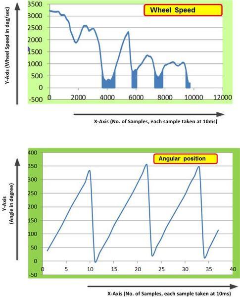

Sorry about late reply (Due to Thanks Giving Holidays)
And thank you for your suggestions.
@sophiecentaur
Yes, I reduced the two step process for calculating the angular position to 1 step as you suggested.
And infact, the low dips in the input Wheel speed signal was due to my fault. There was small bug in my filter coding. And here I attached my final graphs here. But, if you see the graph of wheel speed signal graph, there are some samples which goes to zero un-intentionally. It is ok, i confirmed it, its due to some other hardware problem. We have to find some other way to avoid this problem.
I once again thank you for your help.
The graph you have obtained of total angle looks more convincing now; it has an uneven gradient in accord with the bumpiness of the input data. Getting rid of those dips was good!
Did you consider putting some false data in (linear acceleration or constant speed) to check that you get the correct answers out?
I'm not clear what you actually want out of the exercise. If you want an estimate of total distance traveled then errors would be reasonable but, if you want to estimate the final position of rotation of the wheel (angle modulo 360) then this method - and in fact any method of integrating velocity - could be extremely error-prone.
Good luck with taking it further.

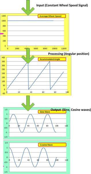

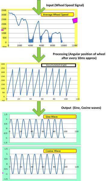

After every 10ms, I need to estimate the current wheel position and then calculate the Sine, Cosine values for this angle. For example...
- At first, I calculate the angular position (say for very 1st sample) and then calculate Sine,Cosine values for that angle.
- And now, calculate the next angular position (2nd sample after 10ms) by integrating with the previous angular position sample and then calculate Sine,Cosine values for the current angular position...
Basically, by integrating the angular velocity, I need to calculate the Angular position and finally generate Sine, Cosine waves. Please check the attached graphs, it has the output sine,cosine waves. One graph shows the real wheel speed input and the 2nd graph shows the data with constant input wheel speed (I change the input wheel speed deliberately to a constant value to check the output sine,cos waves).
And as you said, I understand, by integrating any calculations like this (angular velocity, angular position) can cause a serious error prone, .. :(... Is there any better way to do ? Any suggestions please ?
Thank You
Thank You
I would have suggested synthesising a sine wave with a frequency based on the reciprocal of an averaged value of the angular velocity. A frequency locked loop (as opposed to a phase locked loop).
