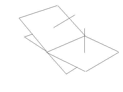

First off, how do the first and second planes intersect? You need to describe this intersection in geometric terms; i.e., in a sentence with words. A sketch of the two planes and how they meet would be helpful. You don't need to include coordinate axes, but you should include a normal vector for each plane.
Here's an example of what I'm talking about. The geometric description should say in words, not equations, what the picture is showing -- how the planes are intersecting, and what sort of geometric object the intersection represents.
