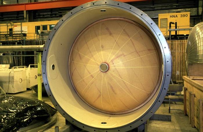

Well, the closest I've been able to find "off the shelf" is a Kevlar window implemented on the NA48 particle physics experiment at CERN.
9703012_05.jpe
This window is a dome with diameter 2.4 meters with vacuum on the concave side. The wall thickness is 0.9 mm. The specific gravity of the Kevlar is 1.35. If this were a full dome, the mass would be about 22 kg. The mass of the displaced air is 8.87 kg.
So this doesn't seem as far off as a 10 pound car.
I'm not sure what calculations went into the design of the CERN window. I'm pretty sure that the Kevlar was chosen because of its extraordinary strength/weight ratio. If we could keep the 0.9 mm thickness (which we know will hold a vacuum), I estimate the "break-even" sphere diameter is 6 meters.
It is not possible to "keep the 0.9 mm thickness". This thickness may be enough to hold vacuum for the part in the picture, but it won't be enough to hold vacuum if the radius of curvature is 6 m. As I said, a homogeneous shell with zero buoyancy in air (made of existing materials) will buckle under atmospheric pressure (this can be confirmed with a very simple calculation). To solve the problem you can use a sandwich shell.
What criterion are you using for buckling? And why do you think that equation is applicable to Kevlar, which is an anisotropic composite?
