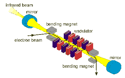

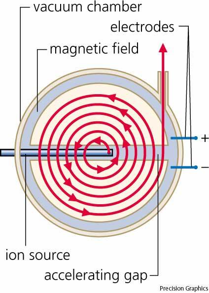

has anyone attempted this as a project?
Forget about the cyclotron itself. Can you just tell me how you are going to produce 1 nC of charge in roughly 10 ps pulse time scale with an emittance of 1 mm-mrad or better? That is the standard to produce a FEL using a typical undulator insertion device.

I planned to use a very high resolution modern computer based signal generator in conjuction with a very specialized amplifier. To drive a pair of large specialy tuned tesla coils to produce the 1 nC of charge at roughly 10 ps pulse time,The Beam spot radius is the hard part... I was hoping i might be able to focus it with electro magnets(focusing coils) before entering the undulator. does that sound viable??

Er.. how? Tesla coils? What does that have anything to do with your ability to create 10 ps electron bunches? What do you think most FEL facilities use to do that? A Photoinjector! And the magnetic field has zero ability to affect the TRANSVERSE emittance of the electron beam, which is what will muck up ANY FEL.
Again, this is all way before the bunches get into your "cyclotron". So we haven't even talked about the problems that pop up in there.
Zz.

the magnetic field has zero ability to affect the TRANSVERSE emittance of the electron beamZz.
so how does the undulator work?
