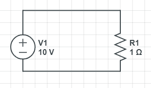

First Assume the following basic circuit:
I read in many textbooks that the electrons in the circuit are accelerated by the positive voltage and decelerated by the collisions, so the speed is constant.
We also know that the circuit current is I = 10A so the power consumed is P = V * I = 100W

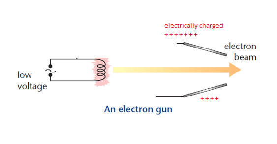

Now assume an electron gun:
Here we have the same situation, electrons are accelerated (by high voltage) but without collisions
So we can conclude that the power consumption by accelerating electrons is P = V * I ?

Power consumption of what? The heated element that provides the thermionic emission of the electrons? Or just the power consumption due to accelerating the electron beam (and dissipated in heat and radiation when the electrons hit the target)?

The power consumption due to accelerating the electron beam, I am not assuming that the electrons will hit a target, I am only interested in the power consumption of acceleration part
So you have the acceleration voltage multiplied by the beam current to give the ##VI## beam power. Adjusted by the efficiency of generating that high voltage (typically about 90% or so, depending on the application)...

Thanks a lot! one more question:
What happens if instead of a high voltage source we put a positively charged metal plate as anode
The electron beam will be accelerated but there is no power consumption ? (assuming that the beam is perfectly focused and no electron will hits the anode)
Who is doing the work in this case?
The anode charging circuit.
Ok but there is no power consumption to accelerate the electron beam?
Yes there is. If you didn't charge up the anode with respect to the cathode, there is no reason for those pesky little electrons to want to leave their warm cathode home and go out crashing into the anode...

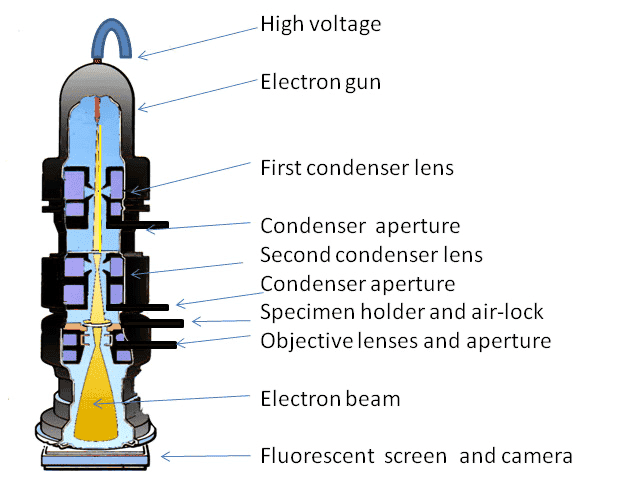

I had a hard time understanding how the consumption of hundreds of watts using an accelerator voltage source can be replaced by a simple 12v x 0.5A dc motor running a van der graaf generator

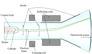

A regular CRT TV tube uses a high positive voltage on the (behind) face of the tube where it is in a 'safe place'. You can see a well insulated red cable feeding the front / side of the tube from the EHT unit.
This allows the rest of the circuitry to operate at relatively safe voltages because 'somewhere' the electrons have to be produced, launched and controlled from regular circuit components. It keeps the rear area of the TV safer for measuring and maintenance.
Any issue of efficiency will be just a practical one because the same total potential difference is needed and the current will also be the same.
Alternatively, when you need to have a low (safe) voltage where the electron beam arrives, the source will be at a high negative potential - for instance when electron beam welding or in an electron microscope.
It's all down to the total PD.
PS Focussing makes no difference to the energy consumption or efficiency as long as all the electrons get to the target. The focussing is a conservative field.
I think for focusing and for modulating the beam current with a "grid", these electrodes are held negative to avoid current being drawn. Control can still be had at positive potentials but then there is current being drawn. The screen-end of the tube is coated with graphite, and the screen is usually aluminium coated, so a current will flow from there as well as from the anode(s). As mentioned, it is safer to ground the positive side of the supply, but the tube does not actually care.
The Anode(s) in a CRT do not take any appreciable amount of current. Their purpose is to accelerate and focus the electrons. The fact that they are flimsy and do not get hot is testimony to that. As with many electron beam tubes (as opposed to conventional 'tubes' with sweaty anodes, the (narrow) beam needs to be carrying the Energy, which is released on contact with either the phosphors or the 'Collector' which absorbs the energy that remains in the beam. See Klystron and Travelling Wave Tube. Badly focussed beams can heat the electron gun and also the helix in a traveling wave tube; the electron optics in a dark art, IMO.
PS if the tube were very long, the trajectory of the electrons would bring them back to the Anode but, first time through, they just rush past.

@rsc9421 The reason you need a power supply for the anode even if you charge it once and the electrons don't strike it is because electrons are charged and negative while the anode is also charged and positive.
As the electrons move past that charged anode , even if they don't strike it they still have an effect on the anode charge. It is like a capacitor where both plates don't touch each other but charging one with excess of electrons or lack of them influences the other plate (the charge on the other plate)If you could just charge an anode and then leave it alone and make it constantly accelerate electrons then you could get free energy, because the accelerated electrons gain kinetic energy which is released as heat/radiation upon hitting a target which is a form of energy. This of course cannot happen! without energy input and the energy input goes to maintain the charge on the anode and the potential difference between cathode-anode.

Ok, but isn't this situation only possible because in the CRT, the screen is the final anode into which the beam energy is also dumped?
If one takes away the HV cable attached to the upper side of the CRT and only leaves the gun intact with it's thermionic cathode heating wires and small focusing anodes, do then we still have a beam exiting the tube neck? You know basically just taking the electron gun alone.
Because the way I understand it is like this. The filament only produces electrons in vacuum, aka the energy supplied is bit larger than the work function of that particular metal of the filament but the electrons that come off of it have no large KE only some random thermal KE that allows them to be free so all KE given to them comes from the E field produced between the cathode-anode, if this is so, then where would the energy come to continually accelerate them without the screen anode?
I suppose you can have no power to the small focusing anodes only if you have the final larger screen anode right? Because then as the electrons exit the smaller tube anodes they are pulled away by the screen anode and therefore don't get attached to the smaller anodes which they otherwise would be ?
I was being pedantic. The thread title is about the gun. The screen is not part of the gun. Without the screen, to collect the electrons with its high + potential, they would return to the anode(s) in the gun, after a long trajectory. Energy has to come from somewhere and I have just been identifying where.
