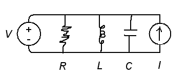

But and if now I add a source of current in those schemes, the ODE changes?
Circuit schematic of a series RLC loop with a voltage source V on the left, a resistor R, inductor L and capacitor C in series on the right, and a current source I at the bottom right.
Circuit schematic of a parallel RLC circuit with a voltage source V on the left, and resistor R, inductor L, capacitor C and current source I connected in parallel across the bottom and top wires.
  • Circuit schematic of a parallel RLC circuit with a voltage source V on the left and a current source I on the right, with resistor R, inductor L and capacitor C connected in parallel between them.

These circuits do not really work. Each of the sources are going to require conditions that are at odds to the other.
Plus, how do you enforce a voltage drop across a circuit with an ideal current source in series? How do you enforce a current source in parallel to an ideal voltage source?
In the former, at best the voltage source does not contribute. The current source acts like the only source. In the latter, the voltage source is the only effective source.
