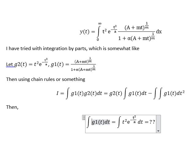

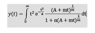

I have been trying to solve an integration that i have
I am not even sure if it's possible. Here, A, m, alpha, a these are constants. I have tried few methods, but couldn't find any way out. I would appreciate any help.

Please show us first some of the methods you HAVE tried, whether or not they failed. (Those are PF requirements.)

Thank you so much for replying.
Like is said, i tried with multiple integration method but individual terms were also complicated, like
then i don't know where to go.

If I were doing it I would simplify it first, by re-defining some of the variables and introducing some new constants. If we start with
[tex]f(t) = t^2 e^{-t^2/a} \frac{(A+mt)^{1/m}}{1+\alpha (A + mt)^{1/m}},[/tex]
and assume that ##a > 0##, we can let ##t/\sqrt{a} = v##, ##C = a^{3/2} A^{1/m}##, ##k = m \sqrt{a}/A##, ##b = \alpha A^{1/m}## and, finally, ##p = 1/m##. We then have the cleaner-looking result that
[tex]\int_0^{\infty} f(t) \, dt = C \int_0^{\infty} v^2 e^{-v^2} \frac{(1+k v)^p}{1 + b(1+k v)^p} \, dv[/tex]
If we further let ##1 + kv = y## (assuming ##k > 0##) we can get
[tex]\text{integral} = \frac{C e^{1/k}}{k^3} \int_1^{\infty} \frac{(y-1)^2 y^p}{1+b y^p} e^{-y/k} \, dy[/tex]
I doubt that there is a closed-form formula for this, but one can tackle it numerically if you are given the parameter values.

Looking at the original integral, we need a > 0 in order to have a convergent integral. Why is that? Well, the integrand is not defined at all if a = 0, and the integral diverges exponentially if a < 0. Next, we need A > 0 in order that (A + mt) be ≥ 0 for all t > 0. This is needed because if (A + mt) < 0 in a range of t-values, then (A + mt)^(1/m) will involve roots of negative numbers, so will involve complex numbers, etc. Finally, we need α ≥ 0 in order to not have the denominator go through 0 at t increases up from 0. If the denominator did go through 0, we would need to worry about the possible divergence of the integral, and whether to interpret as a principle-value integral, or whatever. All these issues are avoided if we just assume all your original parameters a, A,m,α are > 0.
As to how to integrate: NUMERICALLY! Or, perhaps you can expand things in convergent infinite series and then integrate term-by-term.

Dear Sir
Thank you so much for you reply and thorough analysis.
Sir, in the 4th line, should it be exp(-v^2) ?
And sir, i tried with MATLAB, it's showing values. I don't know how they got the value.
and what did you mean by "expand things in convergent infinite series", how do i expand that term, especially that y^p/(1+b*y^p) format?

I suspect that there is NO possible formula. I did say---more than once---that I guessed you would need to do numerical integration when looking at a numerical example (that is, with numerical values of the inputs). MATLAB probably tried some "analytical" methods, found it could not be done, and then applied one of its built-in numerical integration routines.
