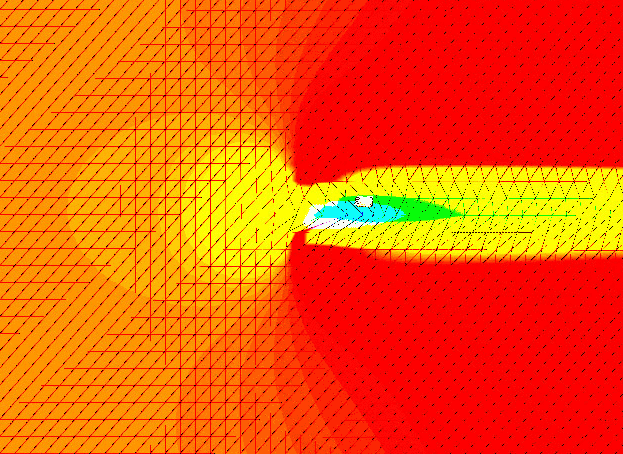

  • #82
The photo given above is from a home made experiment. I have made a simple homemade device where I have put a turbine like structure inside a tube and placed a convergent nozzle like structure at the inlet and placed the structure before a table fan. Thanks to one of my friend who temporarily handed me over the infrared camera to take pictures. I have take and few pictures with varying speed, but every time I have found that the air coming out of the structure is colder than the inlet like the picture given above. Though the slower the input speed, the lesser is the difference.
Now, what can be proved by it. At least I can say that the nozzle like structure have converted internal heat of the input flow into velocity and that has been converted into power. That's why the exhaust is colder.
  • #83
I have no idea what I'm looking at.
  • #84
This is tough to interpret, but it seems you might be circling back to what you were told in post 2: during expansion out of a nozzle, internal thermal energy is converted to work. You were claiming the opposite: that during compression, you could convert thermal energy to work. That is still wrong.
An infrared photograph of the device during its work.
  • #87
The turbine like structure is inside the tube and the nozzle like structure is at the inlet. Therefore, if the turbine doing some work here, it's out of the nozzle. How you are interpreting something real is beyond my knowledge.
Can you tell me which factor is reducing the temperature of the input air?
  • #88
But you've made no indication of scale or where the walls or devices are located or pressures or anything. The photo is essentially useless without more information.
  • #89
What device from which post are you referring to? If you are referring to Post #82, the only thing I know for sure about the setup (a regular photo would help...) is you powered the device with a table fan, which means it is way, way below the velocity required for the effects of pressurization to manifest.
Also, air is transparent to the infrared, so you can't take pictures of it with an infrared camera. So there's that too...
  • #90
It's a homemade experiment and laboratory like perfection can't be expected.
As far as I know, we can study the effect of temperature to air by adjusting the infrared. Actually, I can't say much about that as my friend is the expert. He has adjusted the camera to detect whether the air coming out is colder or not. But I can say that the picture isn't something made with animation. It's real!
