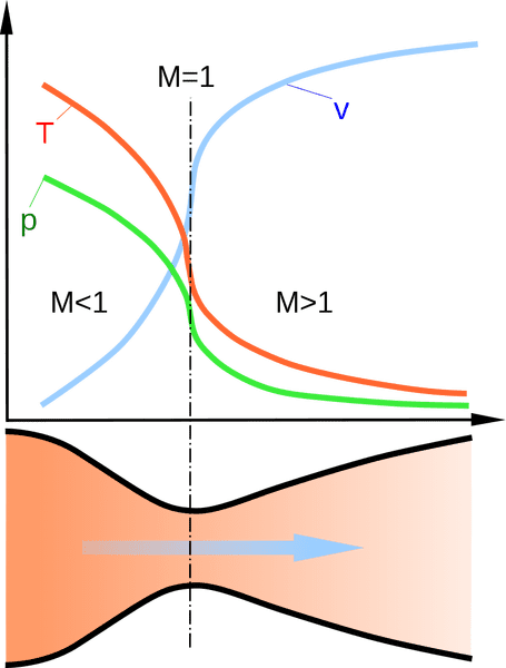

I think we have all witnessed that air escaping through a nozzle from a high pressure tank is cold. But that is air flowing from high pressure to lower pressure. That is how it will always flow. Your question was whether a venturi would help you to get air to flow from low pressure to higher pressure. The answer is no. You will have to raise the pressure of the air source higher than the pressure of the tank you want it to flow into. Any restriction like a venturi will not help; it will make it harder.
The picture from wikipedia clearly shows how both pressure and temperature falls with the increase in velocity. Inside a nozzle, the speed of fluid increases with decreasing radius of the pathway and in case of a convergent nozzle, the speed is at the peak at the throat. In case of convergent-divergent nozzle, velocity increases even after exit from the throat. It's also a known fact that both temperature and pressure decreases inside a nozzle as soon as it reaches the throat. This basic phenomenon is totally different from the scenario what you have described. in your described case, cooling comes because the compressed air has done some work by increasing its volume and that reduces its temperature.

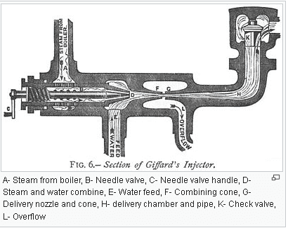

is this any help?
https://en.wikipedia.org/wiki/Injector
A steam injector is typically used to deliver cold water to a boiler against its own pressure using its own live or exhaust steam, replacing any mechanical pump. This was the purpose for which it was originally invented in 1858 by Henri Giffard. Its operation was from the start intriguing since it seemed paradoxical, almost like perpetual motion, but its operation was later explained using thermodynamics.[1] Other types of injector may use other pressurised motive fluids such as air.
Operation
The injector consists of a body containing a series of three or more "cones" containing nozzles along one axis.
It uses the Venturi effect of a converging-diverging nozzle on a steam jet to convert the pressure energy of the steam to velocity energy, reducing its pressure to below atmospheric which enables it to entrain a fluid (eg. water). After passing through the convergent "combining cone", the mixed fluid is fully condensed releasing the latent heat of evaporation of the steam which imparts extra velocity to the water. The condensate mixture then enters a divergent "delivery cone" which slows the jet, converting kinetic energy back into static pressure energy above the pressure of the boiler enabling its feed through a non-return valve.[3] [4]
Most of the heat energy in the condensed steam is returned to the boiler, increasing the thermal efficiency of the process. Injectors are therefore typically over 98% energy-efficient overall; they are also simple compared to the many moving parts in a feed pump.

The diagram he posted makes use of internal heat as well.
From its parent article https://en.wikipedia.org/wiki/De_Laval_nozzle
A de Laval nozzle (or convergent-divergent nozzle, CD nozzle or con-di nozzle) is a tube that is pinched in the middle, making a carefully balanced, asymmetric hourglass shape. It is used to accelerate a hot, pressurized gas passing through it to a higher supersonic speed in the axial (thrust) direction, by converting the heat energy of the flow into kinetic energy. Because of this, the nozzle is widely used in some types of steam turbines and rocket engine nozzles. It also sees use in supersonic jet engines.

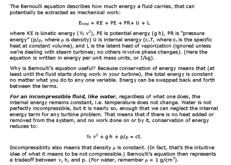

We're all so accustomed to using Bernoulli for incompressibles that we forget (well at least I do) it has a term for internal energy.
As an old broken down EE i seldom delve deep into Bernoulli . It always made me feel sympathy for Mechanicals - my Ohm's law is SOOO much simpler than theirs.
http://geosci.uchicago.edu/~moyer/GEOS24705/Notes/Bernoulli.pdf

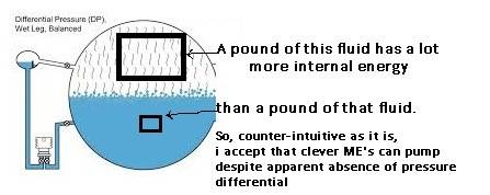

FactChecker said:
Air does not go from low pressure to high pressure just because of the shape of the opening.
Quite so.
Look at a boiler
They take out high energy fluid and use it to pump back in even more low energy fluid.
A piston or turbine driven pump would be intuitive.
But Thermodynamics is where one has to have faith in his math.
I suppose if i'd ever worked on one of those things i'd be less amazed at the thought of it.

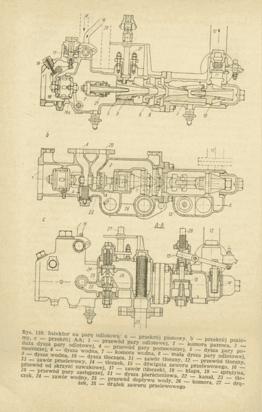

There are exhaust steam powered injectors as well . They use engine exhaust steam at very low pressure and still get water into the boiler . They are truly amazing things - they seem at first sight to defy all laws of thermodynamics - though of course they do not . They do take some understanding though .
