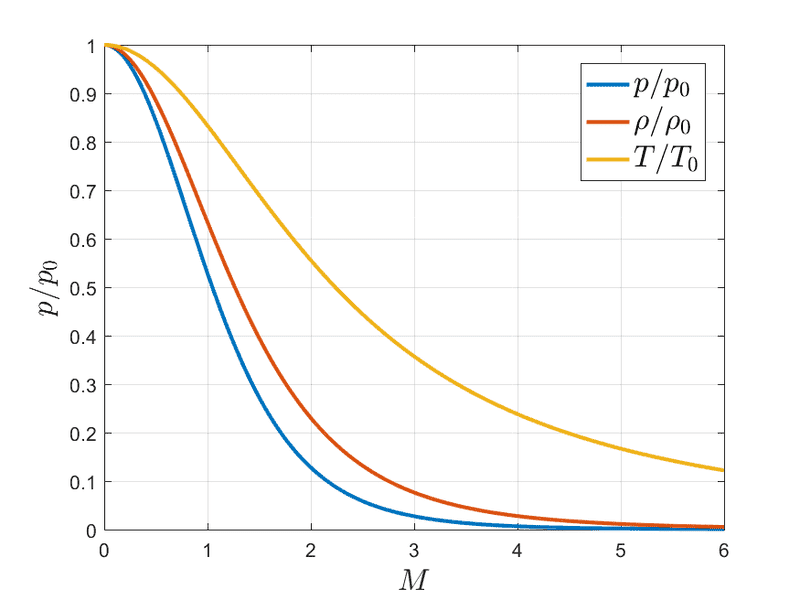

  • #39
As shown in the graph of my first post the c/d nozzle reduces the pressure, if that is what you mean by 'effective' pressure. It also increases the velocity which can be expressed in another way as 'dynamic pressure'. But dynamic pressure is 'potential' pressure, not actual pressure.
It's like considering an object at an height of 10 meters and a speed of 31.32 m/s going upward. The object has the potential to reach an height of 60 meters ##\left(= \frac{31.32^2}{2g} + 10\right)##.
What is the effective height of the object? It's still 10 meters. Even if you double or halve the velocity, it will always be 10 meters. The 60 meters is not an actual property of the object (just like dynamic pressure), it's a potential result that can be achieved if you set the conditions right. One could refer to the 50 meters as 'dynamic height', which would only express the amount of kinetic energy stored in the object.

[tex]d\left( e + \dfrac{V^2}{2} + \dfrac{p}{\rho} \right) = 0[/tex]

Where ##p_t## is the total pressure. Plotting the equation ##\frac{F}{p_t A}## for ##\gamma = 1.4##, you will notice that it is at its maximum (##=1##) at ##M=0##. It actually decreases as ##M## increases.
I'm pretty sure the previous analysis is wrong because it doesn't take into account the compressibility effect.
The thing is that as the speed increases, the fluid decompresses (lower density) which releases the internal energy and the temperature drops. But when you slow down the fluid (hitting the blade), you have to compressed it again, so you cannot actually used that energy to push on the blade. Everything comes back to the initial state.
It's like if the moving fluid was a moving spring. When you accelerate one end you see the spring decompressing and you're thinking: "Look, I released some internal energy. Great! I'll use it to do some work!" But when the first end of the spring hits the blade, it slows down. Then, the other end that follows still arrive at a higher speed (It has accelerated too), thus the spring re-compresses itself and you loose the energy you gained earlier. The only difference with a moving fluid is that it happens in a continuous fashion. Maybe my comparison is questionable, but it might help further the discussion from more knowledgeable people than me.

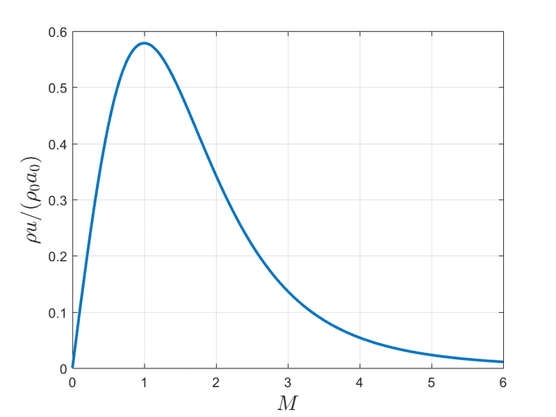

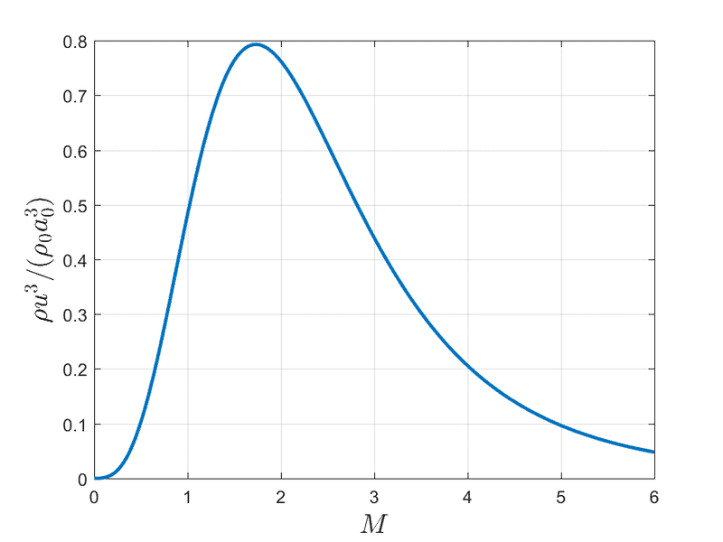

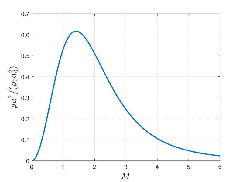

I'll even do you one further. Using a similar analysis to that which I did above, you can get similar relations for ##rho## and ##T##, which are plotted above. You can also pick a Mach number you'd like to use and use its relationship with velocity, namely ##V = Ma## to derive a relationship for a dimensionless momentum flux (##\rho u^2## in a one-dimensional flow) as a function of the ##M## and ##\gamma##.
So, the end result is that if you assume you have expanded your flow to be moving one dimensionally, then the plot of momentum flux versus Mach number looks like the following:
So, there actually is a peak in momentum flux that occurs as ##M\approx 1.41##. Momentum flux is probably the closest related quantity to force on an object it eventually hits. If you imagine an object redirecting all of that momentum flux, then it requires a force in order to do that. However, this has nothing (directly) to do with pressure (or "effective pressure", whatever that may be), and you can never recover more pressure than exists in the form of total or stagnation pressure.
In case you were curious, I also included similar plots for mass flux, ##\rho u## (the maximum is unsurprisingly at ##M=1##) and the kinetic energy flux, ##\rho u^3##, which has a maximum at ##M\approx 1.73##.
