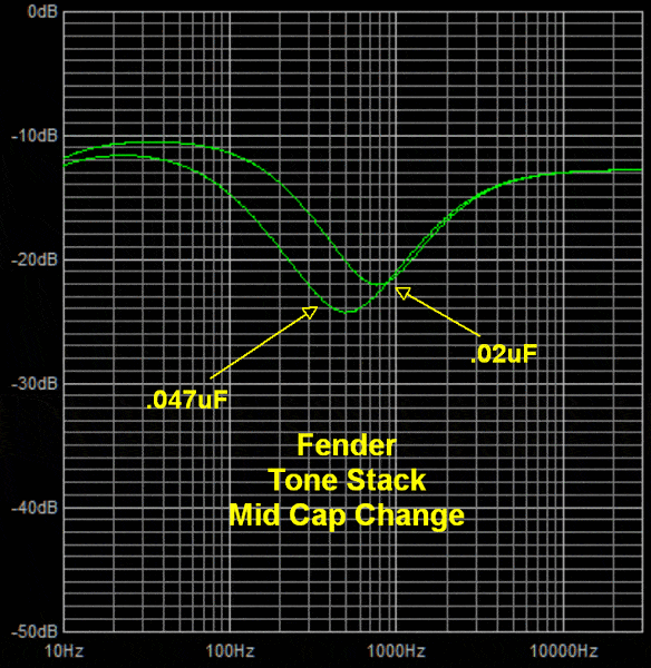

I find it difficult at times to relate what I see to what I am likely to hear. This is an example of a component change which will change a sound. I find it hard to look at the graph and have a really good idea of what I am likely the hear.
Oscilloscopes seem to be pretty hard to use to display distortion in the audio frequencies. I guess there are high quality scopes that are easier to use than the one I have. For one thing, there is a very limited or no description of some of the FFT functions in the user's manual for my scope.

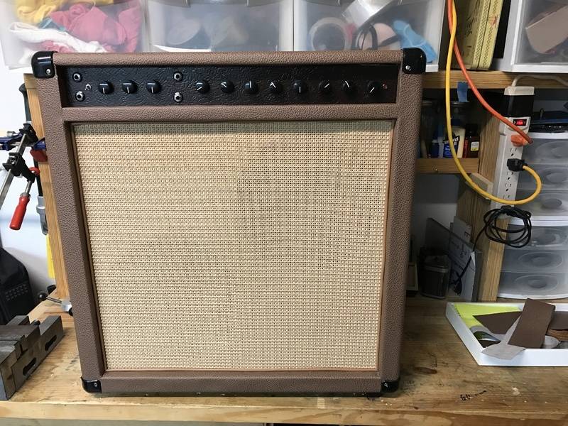

This whole amp project has been more difficult than normal due to the fact I built everything from the chassis to the wooden case and did the Tolex covering.
I assume I posted a photo of the finished amp somewhere but here it is just in case.
Cheers,
