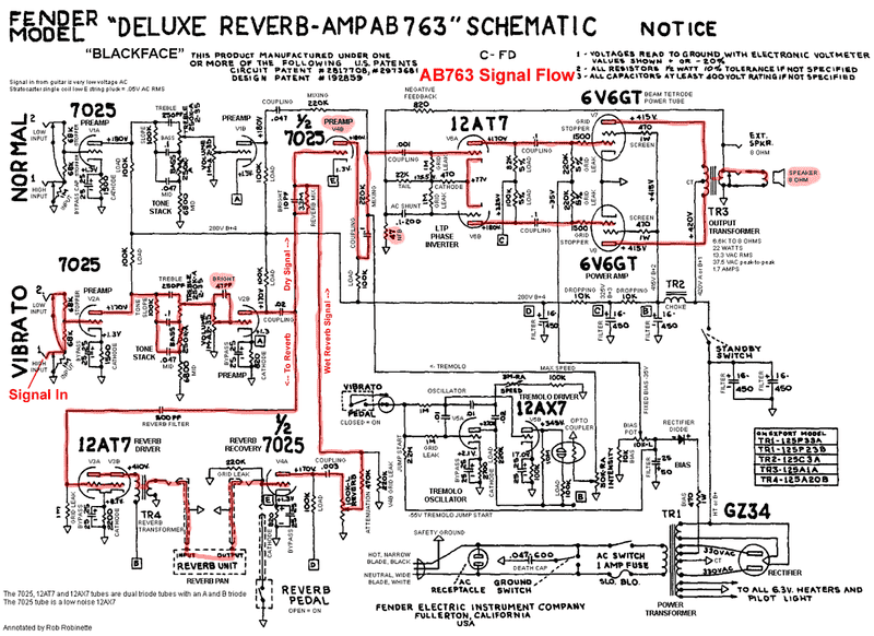

I turned the amp on this morning and the intermittent crackling noise came back. It occurs on the low E string and A string. It is the typical sort of noise I have heard many times associated with issues with tube sockets. The sort of noise that is caused by arcing. As this is a new amp built with the best components I could find so some of the typical issues with old amps do not apply. Also the AB763 Fender circuit has been used in thousands of amps in one form or another and the Deluxe Reverb is not known for instability.
After I finished the amp there was a problem with the reverb recovery circuit causing hum and unusual noises. I measured the value of the components and found nothing wrong. I finally got tired of dealing with the issue and replaced the plate resistor, cathode resistor, cathode cap and the .0033 coupling cap. That solved the issue and the amp started working without issue. I don't know which of those components had actually failed or why they failed. Bad component? Overheated them when I soldered them in? Who knows. This problem is part of what prompted me to ask questions about troubleshooting noise.
It is entirely possible that I got a bad batch of caps. They were all best quality brands, Sprague Atom, Nichicon, Cornell Dubilier 715/PS Film capacitors.
So...the issue is more or less constant now and I hope I can reproduce the fault with signal injection which is a lot easier to deal with than playing the guitar and looking at the scope. I don't think this is circuit design instability. If I am lucky it will be a failing component. Worst case is a bad solder joint or something unusual like a bad stand by switch that is arcing. If the fault is in fact arcing it can be hard to find.
If I can find what stage or tube is associated with the issue the problem can be fixed even if I have to take the shotgun approach and just replace the components associated with that stage.
I am going to take the chassis out now and start looking. I will post the results. I really want to get this issue fixed so I can get back to my original questions about using scopes and other methods for tracking down noise in general.

Here is a video of the issue.
I have made a lot of changes and tried a lot of things with no results. I really have no idea at this point what could be causing this issue. I guess it is possible the amp had done this from the beginning. It is hard to imagine I would not have noticed it after I resolved the hum issue in the reverb recovery circuit. At that point the amp sounded great as I tried the two new different type of speakers I was testing.
Perplexing to say the least.
Billy

Hi Jim,
Sorry the video did not "show" much. It was meant just to let you hear the sound.
I have played the amp though a quad Marshall cabinet with four 12" Celestion with the same results. The little Orange amp is a small transistor amp I use to hear the results of a probe placed at different points in the circuit. The speaker you hear in the video is a 12" Weber DT12 30 watt guitar speaker.
The issue is definitely in the amp. The greater question is about what the amp should normally sound like. Is this buzzing normal for this design? I don't think so but I have not found any defective component as of yet.
I also plugged the amp into a another Weber 12" 65 watt speaker designed with a Neodymium magnet. The speaker is more efficient and has a different bass response. That speaker reduced the buzz by a small amount.
The buzzing noise happens on both channels. It happens when channel one is disconnected and the reverb stage and tremolo stage are disconnected.
That only leaves V2A and B, V4B, and the phase inverter and of course the power stage. I went back and checked all the voltages and ripple values plus the bias on the output stage tubes. I replaced coupling caps and cathode caps and resistors on V2 A and B. I measured the resistor values on the rest of the amp. All this without finding any issues. No change.
If I have too I guess I can start changing coupling cap values to change frequency response and reduce the capacitance of the cathode cap. All that is a bit over my head to calculate but I can figure it out if need be.
Jeezs...I just want to build amps, not worry about being in the corner with any frequency ...lol I know, I know, silly joke
Cheers,
Billy
EDIT: The amp is around 20 watts, and yes it would be capable of overdriving a small speaker. The whole video is with the amp volume turned up less the 50%.

Could be that's going on, is there a schematic of this little guy someplace ?

Here is a schematic. There are a few changes in the amp I built relating to the tremolo circuit. I have disconnected the tremolo circuit which did not change anything with the fault.
I have the reverb driver and reverb recovery disconnected, also what they are calling the vibrato circuit disconnected to make looking for the fault less of a problem.
Fender Deluxe Reverb AB763 amplifier schematic, with the signal flow path from the normal and vibrato inputs highlighted in red through the preamp, phase inverter and power amp stages to the output transformer.

Next thing i'd do is lift the feedback resistor.
Small hand-drawn schematic fragment labeled NEGATIVE FEEDBACK, with a resistor marked 820 connected between two points of a circuit, and the label AB7 at the top right.
It only wraps the phase splitter and output stages and splitter gain is only about 1, so i'll be surprised if that's causing your trouble, bur i might be missing something...
If it's really negative feedback then lifting it should make the amp louder. If it lowers volume instead then it was positive and the output transformer leads are rolled.
If lifting it changes things in some curious way i'd patch a 10K pot in its place and experiment with value of feedback resistor .
Above should tell you something about feedback.
Observe Svein's TIM link says the fix is to have feedback wrap individual stages. That comes natural to us old control guys , we spread out gain of a loop and take precautions to not drive the middle against a limit for that destroys your linearity.
Your feedback only wraps two stages, not bad. Just make sure it's really negative.
My two cents.

ps that 47 ohm completes the feedback voltage divider . 'Scope it with and without feedback resistor. I'd expect nothing there with fb resistor lifted. But as i said, this poking around challenges my preconceived notions about how the circuit works.

3. This is not caused by the value of the negative feedback resistor. I had installed a switch which provided three conditions of NFB. 820 ohms, 470 ohms, and no NFB. The fault appears at all three conditions.

After digging through every connection in the amp and removing even the smallest fault I did the following.
I ran the output into a 8 ohm resistive load and disconnected everything connected before and after V2. At that point there is only the input jack, the grid resistor and plate resistor and the cathode resistor connected to V2A. There was no noise on the plate of V2A. The low frequency "noise" is present on V2B plate. It is not present on V2 grid. I replaced the V2 tube socket and tube and replaced the cathode resistors and cap. At this point I was 99.9% sure all the components were working correctly per the schematic. I had previously replaced components in the tone stack.
I listen to each connection of V2 with a probe connected to another amp while playing my guitar.
The cause of the low frequency noise is a function of the design of the circuit.
After removing every little bit of crackling in the amp due to very small connection issue like imperfect tube socket fit, I was left with only the low frequency distortion/buzzing being created by the amount the V2 tube was being driven past it's optimum curve.
This is evidently inherent in the original Fender Deluxe Reverb AB763 circuit design.
With all other issues that compounded the problem eliminated, the amp actually sounds fairly normal.
As the configuration of both channels are the same, that is the tone stacks are the same, I will redesign one of the channels to produce less preamp drive and therefore less distortion and less bass response. The general idea is to have one channel be the drive channel and the other be the less driven channel. This will also require the installation of a channel switching circuit which I am sure will be a bit of a challenge to design and install. Also a foot switch that then will have three switches. One for the reverb, one for the tremolo, and one for channel switching.
