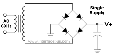

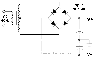

How is that DC from TR1 derived?
EDIT i cut and pasted pictures below without checking closely enough
that author drew his diode bridges rotated 1/4 turn from correct orientation
rotate them 90 degrees CCW before using
see dave's post below
thanks Dave
(chagrin icon) :eek:
or
or
In either of the latter two your TR1 transformer's centertap is already circuit common
so you also could tie the TR2 transformer to circuit common .
If the first, don't connect TR1's winding to TR2's winding.

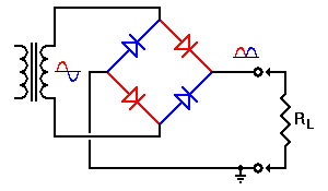

Those bridge diodes are incorrectly connected
whoever drew them didn't see their mistake or don't understand
take the top circuit
voltage from the 1/2 cycle coming out the top of the transformer winding is going both to ground and the V+ output
don't think that will work too well ... the same error is perpetrated in bottom drawing as well
correctly drawn example ...
Did I miss something in the discussion, @jim hardy ?
Did you show those incorrectly on purpose to make a point ?Dave
jim hardy said:
Not at all and good catch ! Thank you !
I cut and pasted from a google search without checking close enough - mea culpa and THANK YOU
That guy pasted his bridge into his drawing 90degrees out !
http://www.interfacebus.com/Glossary-of-Terms-full-wave-bridge-rectifier-circuit.html
shame on him and me both.Sorry about that ...
no probs ... just wanted to make sure you weren't trying to teach the OP something and see if he could pick the problem LOLD
