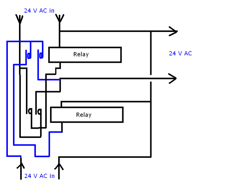

Background Info: I have just expanded my already huge sprinkler system (16+ zones). The old timer only controlled 12 zones so I added an additional timer to control the new valves/solenoid. Each timer needs to output 24VAC to the main valve solenoid and one respective valve (without the main valve turned on, there will be no water reaching my other valves). So the old timer controls 12 zones (from before) + Main Valve & the new timer controls 4 (new zones) + Main Valve. The main valve must be turned on to let water flow to the manifold where the other valves are.
With one timer, life was simple. 2 leads (24VAC polarity doesn't matter) went to the main valve and the timer would turn it on at the beginning of the watering cycle (it would also turn on each zone one at a time to cover all of the backyard).
Now with two timers, both timers will need to turn on this main valve solenoid. At most times (ideally), only one timer will be supplying power to the main valve. However I want to play it safe (in case both timers decide to turn on at the same time) and feed 24V to the same main valve. I need to isolate the two sources.
Soo...I have two 24VAC sources and need one output to the solenoid of the main valve. If either one of the sources is active/triggered by any of the timers, output should shoot 24VAC. Sprinkler Valve Solenoid shouldn't take more than 2 amps
Now I was thinking of using a couple of diodes but remembering back from college, I think they are effective for DC circuits (and only half way block AC current). Please help me create a diode/relay schematic to put this together or if there are any other suggestions.

Building codes may require you to use only relays. Relay logic is common in complex building wiring systems, especially those involved in safety and fire protection. Relays are more idiot-proof than semiconductors.

Unless you know that the 24 volt sources are exacly equal in voltage, (and you don't) it is probably not safe to put them in parallel, which is what you said originally.
One way that sorts this out is to have two new relays arranged so that if one is activated, it removes power from the other.
This way, you can't have both power sources supplying the main solenoid at the same time.
In the diagram, you can see that each relay coil will be activated by one incoming 24 V supply and when it does, it cuts off the line from the other power source to the main solenoid. So, the first power source to be turned on will be the one that supplies power to the solenoid.

Well if he was going to do it that way, just get one relay, have one timer connected to the coil, the other timer connected directly to the valve, and the 24V power source connected to the contacts of the relay, and the valve connected to the N.O. contacts of the relay. In this setup, if the timer connected to the coil is "on" it will energize the relay, connecting the other timers power source to the valve, and if the other timer will control the valve directly. If both timers are signaling "on" at the same time, it is of no conciquence, because the valve, in the end is only powered by one power supply. For that matter, just get one big power supply to power both timer units, hook the main valve outputs in parallel and be done with it.
Here is a simpler version of the switch.
The top 24 volt supply gets used if the bottom one isn't powered on.
If the bottom one is powered the relay pulls in and power comes from the bottom 24 volt supply.
If the top one also comes on, it doesn't matter because there is no path from that supply to the output.
