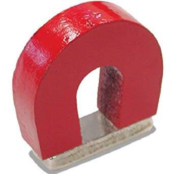

I am trying to find a way to decrease the force between two magnets by putting a physical barrier in the middle of them. I’ve reasearched and found that Mu metals redirect the flux of the magnetic fields so those two magnets shouldn’t have any noticeable attraction between them. Of course, before buying Mu metal, I would like to ask if will it work and is there another material that can do such a thing?
What shape are the magnets? If horseshoe, just put a keeper on each of them...
https://images-na.ssl-images-amazon.com/images/I/41Q2p4idMrL._SX342_.jpg
Red-painted horseshoe magnet with its two poles at the open end, a silver metal keeper bar across the bottom of the arms.
  • Red-painted horseshoe magnet with its two poles at the open end, a silver metal keeper bar across the bottom of the arms.
What shape? Can you post a picture? You can use the UPLOAD button to add a PDF or JPEG file, or you can click the little painting icon to paste in a URL to a picture, like I did for the red magnet above. Also, can you show how the 2 magnets are arranged?
If you just put a piece of ferrous metal between the two magnets, it will likely increase their attractive force. You need to figure out a way to redirect each magnet's field so it closes between the two poles of each of the magnets without going near the other magnet...

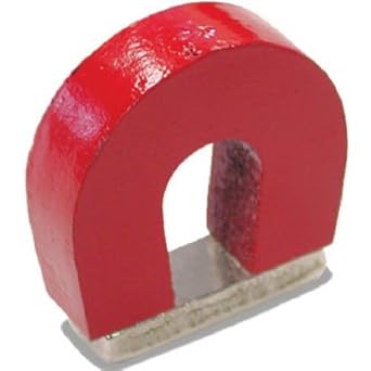

Photo of silver metallic disc magnets: two stacks of about ten discs on the left and two loose discs on the right, all with a polished nickel-plated finish.
I have one magnet laid down like the two magnets at the right, and a group of magnets ( like the one of the left of the image )on top of the singular magnet. Both interact with repelling forces and I need to put something in between so that those forces barely act on each other. Any ideas ?
  • Photo of silver metallic disc magnets: two stacks of about ten discs on the left and two loose discs on the right, all with a polished nickel-plated finish.
So it looks like those magnets are magnetized axially (one flat face is N and the other flat face is S). To contain that B-field, you need a u-shaped piece of ferrous metal that you can slip over the top and bottom faces that fits fairly close to both, and has the two outer pieces connected along one or 3 of the sides. I couldn't find a picture of one, so hopefully that makes sense. If you only do that "keeper" for the bottom magnet and not the top stack, the top stack will be attracted to the ferrous keeper below it.
What spacing are you wanting between the bottom magnet and the top stack? Are you wanting to go from repelling to no force (other than the force of gravity on the top stack of magnets)? Are you wanting to basically turn "on and off" the repulsion? Would going from repulsion to attraction also work?
BTW, having the keeper that close to such a strong magnet will likely require a fairly thick keeper wall, to avoid saturation. Once the keeper material saturates, any B-field above the saturation level leaks past the keeper and will still interact with the other magnets.

I’m hoping to turn on and off the repulsion. Basically put both magnets at a small distance ( 5-7 cm ) and from time to time, be able to put any material between and observe how there is no repulsion when the material is in between. My following question is does that ferrous metal which forms part of the keeper attract or repel the magnets? , because I’m trying to avoid it. Also, were could I get such a keeper? Thank beforehand for the help.
