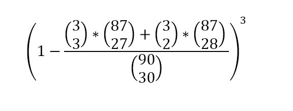

cdux
187
"90 students are split randomly into 3 groups of 30. What is the chance for 3 particular students A, B, C to end up each in a different group?"
One of the right answers is (90*60*30/(90*89*88) but I wonder if my type of solution can be corrected for the same result.
PS. I hadn't initially mentioned the part about "particular students A, B, C". I wonder if it's part of the mistake..
probably not though.
OK let me rephrase / alter the question since it may be too confusing:
Is there a way to solve that question by chiefly using Combinatorics? (and not just step-by-step probability logic)
I can see that the denominator of the '(90*60*30/(90*89*88)' solution can maybe be translated to k-permutations of n, but what about the numerator? Is it forced to only be a case of the basic principle of enumeration or is there a more concise formula to express it?

I tried to put your first answer in the calculator, and it does not seem to give the same answer as the other answer. I think that in order to answer why it is a wrong answer, you need to explain how you thought when you got it.
Thank you. Excellent answer.
And so involved. I don't know why they include them as 1/5th (or less) of a curriculum. This is so interesting (and complex) as a subject that it deserves 6 months on its own.
Though I wish it was possible to eliminate that "90->60->30" succession from the arithmitic. For some reason it sounds unintuitive (though it may be just me).
I had also heard of another impressive (and correct) answer that starts with the denominator being all possible arrangements of the students: 90!/(30!*30!*30!).
My attempt started with "all possible arrangements of the 90 students in 30-student groups" as denominator and then I was trying to eliminate having "either 2 or 3 of the same 3 in the same class" on the enumerator and then reversing it to get "neither 2 or 3 in the same class" (it was also confusing that 0 of them would be impossible because that would mean at least 2 would be in another group so I didn't know if it should be included).
I suspect that I did a mistake at least with the denominator because it might produce more combinations than possible (judging from correct answers) but I'm not sure..
Really?, I tried evaluation this expression, but I did not get the same answer.
I am not sure about everything you do, but a lot in the expression in your first post seems unnatural.
If you want to calculate the probability by excluding 3 in one group, and 2 in one group, you can calculate it like this:
[itex]\Large 1-\frac{{3 \choose 1}*{87 \choose 27}}{{90 \choose 30}}-\frac{{3 \choose 1}*{3 \choose 2}*{2 \choose 1}*{87 \choose 28}*{59 \choose 29}*{30 \choose 30}}{{90 \choose 30}*{60 \choose 30}*{30 \choose 30}}[/itex]
This expression gives the same numerical answer as(90*60*30/(90*89*88))
The first fraction excludes 3 beeing in the same group, and the second excludes 2 beeing in the same group. You have to account for the fact that you can choose any of the 3 persons(when 2 are in the same group), and any of the 3 groups. I think this is more complicating than calculating it directly.
However, even though you asked for a combinatorical approach, I am curious if there is some cool shortcut we can use to get (90*60*30/(90*89*88)), but I do not see it right now.
