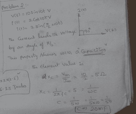

Can someone explain me what happen in this step? Circuits 1

http://imgur.com/tQR7Jdt
xc= vm/im
http://imgur.com/a/RwIUA
Can someone please explain where did they get that pi/2 ? did they integrate 2cos(10t)or something? Thanks
They changed the trig function used to describe the current from a sine function to a cosine function. This just involves a phase shift.
thank you i see now
