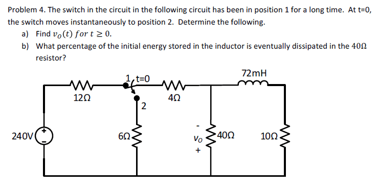

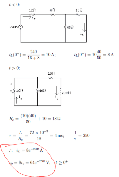

Could someone explain me what happened in the step that is circled in red please? I would appreciate it.
did they multiply i0x(iL)?
they got iL by using iL=iL(initial)*e^-t/Tau . How did they get Vo? what formula did they use?

I think I got it. I did Current divider io= 40/40+10 (8e^-250t) . I got 6.4e^-250t Amps then using Ohms law with the 10ohm resistor I got 64e^-250t V can someone confirm it please?
and that 10ohm resistor in the far left should have the same voltage as the 40ohm resistor correct?

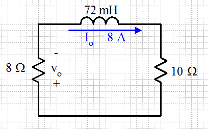

No, the inductor will have some potential difference across it as it attempts to drive current trough the circuit. So that PD plus the PD across the 10 Ω resistor will be the same as that across the 40 Ω resistor.
You'd be better off simplifying the circuit a bit before proceeding. When the switch commutates to position 2 it places the 4 Ω + 6 Ω series resistors in parallel with the 40 Ω resistor. So you're left with:
So, do with that what you will! :smile:

I was referring to these two circled resistors, don't they have the same voltage because they are in parallel? I found the io using current divider io=(40/50)(8e^-250t), then use that io to find vo with ohms law.
Yes they share the same potential difference. So your expression for the current through the 10 Ω resistance looks good.
You can do the current divider, then use one resistor and its current,
OR
you can use their total current and their combined resistance. Either way should give the same result.
