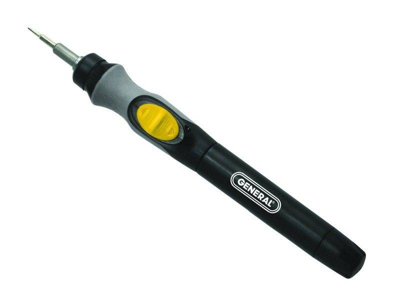

I plan on using PCV pipe for the main body. The drill's purpose will be to install screws into pre-cut groves (basically a motorized screwdriver). These screws will be only a couple centimeters tall so the motor will only need a moderate amount of torque and rpm. It takes about 3 turns to install these screws but i would like the fit to be tight so maybe a little more than that would be excellent. I would like this drill to be able to unscrew as well .
The problem:
I need to chose a small motor that has enough power/torque and rpm to screw in the miniature screws (as well as unscrew) without stripping the groves at a fast but controllable speed. The motor needs to be small but effective and precise. I'm just not sure what kind of motor fits these requirements. Please help?

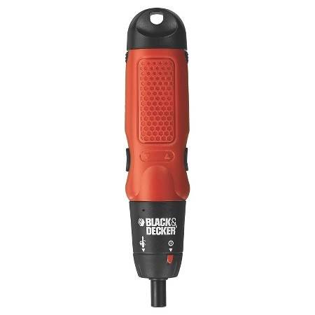

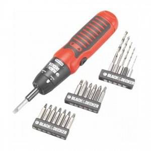

Try looking up the technical details of commercially available powered screwdrivers to get some design ideas .
Most small motors will be way to fast for what you need so some sort of reduction gearbox will be required. This will also increase the torque and that might cause problems. I think you need to look for an adjustable means of limiting the torque and this is a feature of many commercial electric screwdrivers.

It is not clear to me why a commercially available tool can not work, or cannot be modified to work for you?

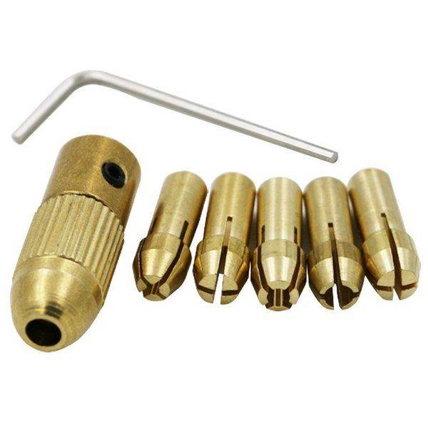

I just planned on using a DPDT momentary ON/OFF/ON switch to reverse polarity. But being able to lock it woud be useful as well and I'm not quite sure how to do that.
As for how to make the clutch, I planned on using the chucks below since I have some handy. However, i'd prefer to use ones that looked like a hollow cylinder, (similar to the hand drills a user posted above) to make it easier to change bits. But since I can't order any
online, I'd have to make that by hand.
