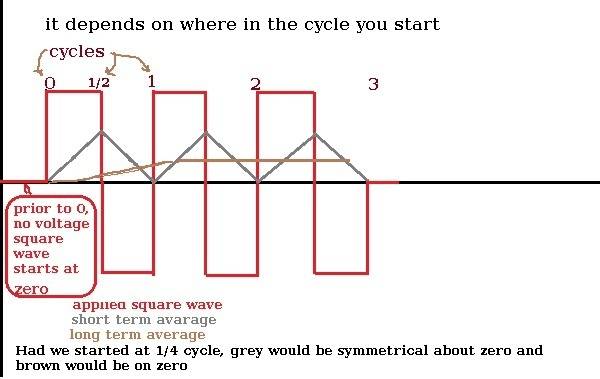

yes it's correct
here's a shot at how it works
it's a quirk of math that the circuit guys quashed for us.
It doesn't even have to be asymmetrical, a symmetrical square wave can have a DC component
but the coupling capacitors in your signal path soon force it to zero
If all is quiet,
then you switch on a nice square wave (or sine wave for that matter)
its DC component depends on where in the cycle you start it. Man oh man is that counterintuitive, though..
Thought experiment time
Let's think of DC as just the long term average, over several cycles
and also consider short term average, most recent half cycle
for the red square wave ,
gray is short term average note it builds from zero in first half cycle then heads back toward zero next half cycle, barely makes it there and turns right around again
brown is long term average which builds to average of gray wave, slower than i showed it though.
so that nice looking square wave has a DC component shown by the brown line,
and how much DC depends on when in its cycle it got switched on.
Same is true for a sinewave
and that's why power transformers have such huge inrush if you close on them at sinewave's zero crossing.
We had a thread on that last year...So,
the coupling capacitors in your signal path not only separate the high plate DC from the low grid DC,
they block any DC that's got your signal because of the random time somebody threw a switch.
More accurately they bleed it down to zero,
and thus spake Lenard .

Ahhh now we're getting there
to get by in today's world we need to be able to think like a pure mathematician
and still get by as a practical technician.

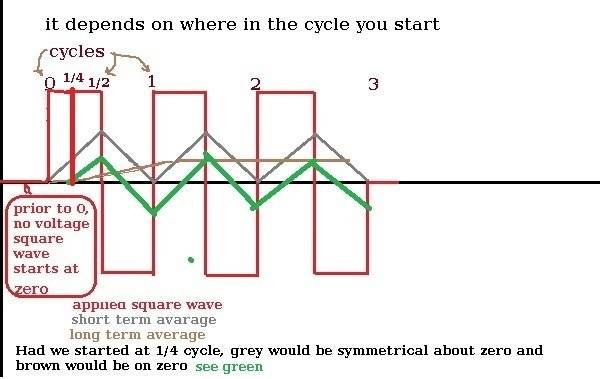

If you redraw that square wave i drew up above
but instead of starting it at zero you start it at 1/4 cycle
go ahead, copy it into paint and do it
draw the short term average this time in say green not gray
observe the short term average now is centered about zero
so this symmetrical square wave has no DC component, but the only difference between the two is where in the first cycle they started
Your scope has FFT which breaks any waveform down into its component frequencies
one of them is 0 hz, the DC component ,,, often calleda0
first wave's 0 hz component is nonzero second one's is zero
