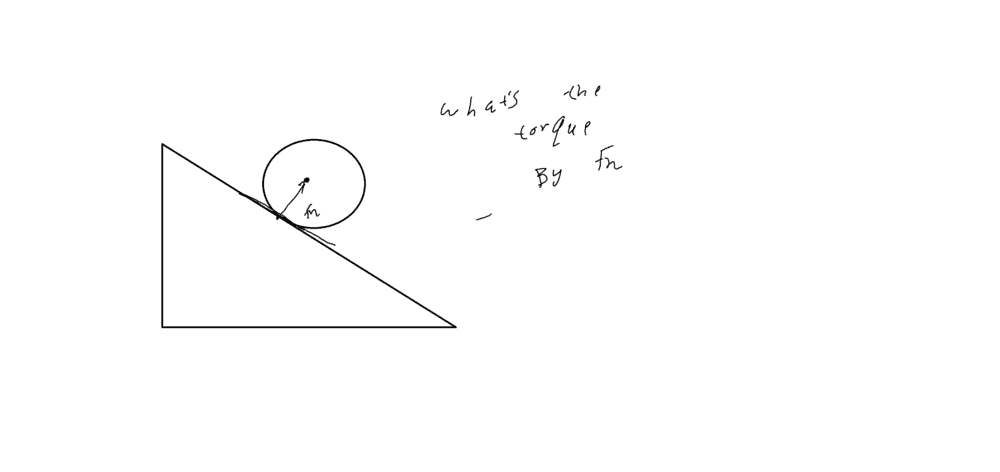

Hi everyone I can't understand how normal force produce torque isn't normal force acts normally on the plane so the perpendicular distance in case if it was like block will be zero, so normal force doesn't produce torque. "case of box"

Here's a geometry question for you: If you have a line tangent to a circle, the normal to the line at the point of tangency passes through the center of the circle. True of False.
Yes
But why square shapes get torque from normal forces

Who says that the normal force results in a torque about the center of the square?
How square in friction surface have net torque of zero
Internal "torques" exist in the form of stress.
But internal torques comes in pair so they cancel each other
As @dsaun777 indicates, if friction is present, the normal force is not distributed uniformly over the base of the square, and the normal stress is greater near the downward edge than near the upper edge on the base.
