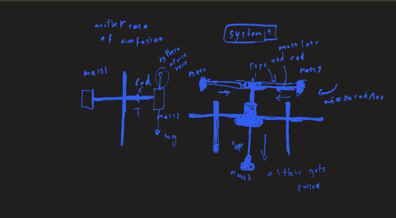

Can you please give more details? If it's a schoolwork problem, post the exact problem statement, and upload any figures that are associated with the question. If it is a scenario that you made up, please make a more detailed drawing with everything labeled so we can help you figure out your Free Body Diagrams (FBDs) for this situation.
Hand-drawn blue sketch on dark background of two systems: left shows a vertical rod with mass 1 on the left end, a mass 2 hanging below with mg and T labels; right shows a spinning rod with masses at each end, a rope, and a hanging mass 3 with an arrow pointing down.
In the system on the right, we have two masses, labeled as mass 1 and mass 2, connected by a rod and a rope. This setup allows the masses to slide closer when a third mass is pulled down. Initially, the system possesses an angular velocity.
for the system on the left, we have a rod with two masses fixed in place vertically. Due to these masses being fixed, there must be an upward force acting on them. However, tension and normal forces act along the x-axis. Does this arrangement imply that the rod is bent, even if not visibly apparent?"

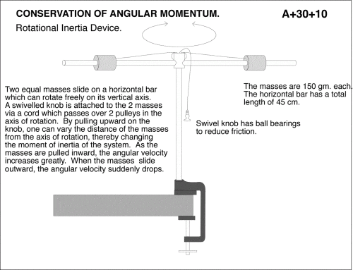

Is it something like this what you are trying to describe?
Diagram titled Conservation of Angular Momentum, Rotational Inertia Device: a horizontal bar rotating on a vertical axis with two equal masses that slide along it, cord passing over pulleys to a swivel knob, clamped to a table.
yes, particularly when the masses are on the edge just touching the bar sideways .

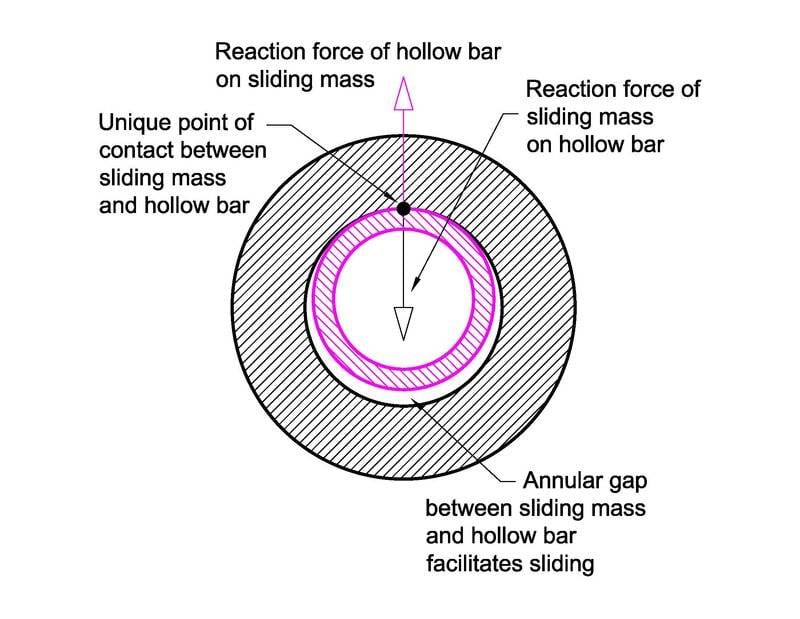

I have drawn the real-world situation between your sliding mass and the bar:
Cross-section diagram of a hollow bar with a sliding mass inside. A black dot marks the unique point of contact at the top, with an annular gap around the rest. Arrows show the upward reaction force of the hollow bar on the sliding mass and the downward reaction force of the sliding mass on the hollow bar.
