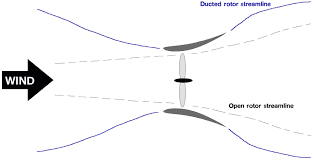

From: https://wes.copernicus.org/articles/3/919/2018/wes-3-919-2018.pdf
  • #49
Yes, and "a handheld anemometer was positioned at various locations in the flow field to gain some understanding of the velocity field near the rotor" So these are local flow velocities.
I explicitly excluded local flow accelerations, which can indeed be higher than free stream (in which case the pressure is lower than static free stream pressure, to keep total pressure in check). But also in the paper the average flow velocity, averaged over the entire inlet, cannot be higher than free stream.
Personally, I think this paper is bullocks... They claim significantly higher than Betz efficiency (2.65 times more!) which is highly controversial. With a duct it might be possible to increase the effective diameter of the rotor a bit, such that in theory you could exceed Betz if you base it on the rotor diameter (instead of the total diameter of rotor + duct). In practice you would likely still be below Betz because most turbine don't exceed Cp = 0.5. But in no way can this lead to a factor of 2.65. This thing is also a far cry from the funnel, without a any turbine in it, of the OP.
So, can you have a local acceleration of the flow at certain parts inside a duct exceeding free stream? Sure, that kind of diverging shape this might be possible.
But the OP actually showed a funnel. A funnel has a narrow part which has either constant cross section or is contracting even further. In that case there will also not be local flow inside the funnel with a velocity higher than free stream.
I also implicitly assumed the simple case of a narrow part with constant cross sectional area. If there are no losses, then the flow inside this narrow part, once established, continues forever, also downstream of the funnel. This means that if the local flow velocity inside the narrow part exceeds free stream, it will also do so downstream of the funnel.
Lastly, you are now talking about very local effects. Nowhere in the OP or in any subsequent posts of him did I understand that he would like to know about these kind of effects (which depend on many things, for which indeed no general statement can be made). I have interpret them as at the very least averaged over the entire cross section.

Ok, let me first say that we go off in a bit of a tangent here, this configuration is a far cry form the OP's funnel.
I also have to come back on the paper, it is less bullocks than I thought when reading it a bit better. They don't claim exceeding Betz by 2.65, they even explicitly state that others do make this claim which doesn't help their cause. They also note that the configuration with duct does not exceed Betz if you take the outlet diameter of the duct as reference (which, as I mentioned in my previous post, is indeed what I think you should do), so that's good. Their efficiency is still higher compared to an open turbine, which sounds plausible to me. So sorry for the confusion there.
I'll be honest, I do not understand how the averaged inflow velocity to a ducted turbine as shown in this paper can exceed free stream. But that is exactly what the paper claims by measurement and computation. So I'm a bit lost, I would certainly want to understand this better.
If they exceed freestream speed ,that doesn't mean they exceed total pressure of freestream.
If speeed goes up then static pressure goes down and total pressure is same again.

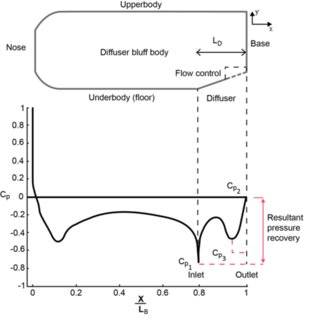

I think for sure can be.
This is how F1 diffusers work,airflow under car bottom is faster then freestream,static pressure drop and you get dowforce meassured in tons!
But F1 diffuser stay in opposite direction as my funnel in this topic..
2-D-illustration-of-the-pressure-behavior-along-the-underbody-with-a-2-stage-pressure_Q320.jpg
Conclusion, if you invert your funnel (and make the expansion gradual enough) then indeed the flow inside the narrow section (now upstream) can be higher than free stream 😄.
