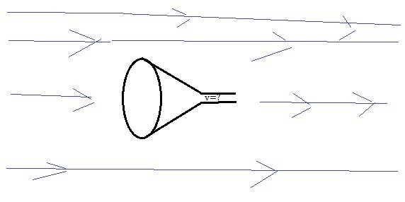

If I put funnel out of car when driving 100km/h, can speed in narrow section in funnel be higher than 100km/h(freestream) and does bernuli equation works for this case?

yes I know how to solve it using bernulli,total pressure must be same,but I don't know can I use it for this case..

Suppose the funnel throat were totally closed (i.e., zero diameter exit opening). What do you think the streamlines would look like?

To increase the velocity through the small end of the funnel the kinetic energy must be increased. To increase the kinetic energy the static pressure must be lowered as per the Bernoulli equation. The flow coming out of the funnel needs to have the same static pressure as the surroundings, flow upstream of the funnel exit can only have a higher static pressure.
This means there is a buildup of static pressure in front of the funnel lowering the kinetic energy of the flow before it enters the funnel. Only then it can increase its velocity again through the small part of the funnel. So when air approaches the funnel its kinetic energy will first be converted to static pressure and then to kinetic energy again. For a perfect conversion the kinetic energy will thus be at most what it began with, thus the velocity through the small end of the funnel can thus at most be equal to the surrounding velocity.
However, at the moment the pressure just before (or in the cone of) the funnel is increased, flow will seep (escape) alongside the funnel, meaning that not all of the kinetic energy that 'hits' the upstream end of the funnel can be used to increase the static pressure. Therefore you 'loose' pressure and the flow through the small end of the funnel is lower than the surrounding flow, always.
On top of this there are also losses due to turbulence and friction.

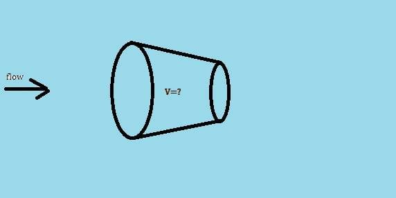

If "funnel" looks like this,than constriction cause increase static pressure and lower speed then freestream?
I don't see how any of my arguments would be different for this case. Why do you think this makes a difference?

I just double check .So every constriction reduce speed compare to freestream..

Air indeed has inertia, but to say that the speed at the outlet of the funnel is higher than free stream means that this inertia (or momentum actually, inertia times velocity) is increased, how would that work? What would be the energy source that does that? It is just not going to happen. Look at it this way:
Say you are standing on the side of the road and a car passes by from left to right. It is a day without any wind. The car drags air along with it and therefore, when the car has just passed, a part of the air will also go from left to right because it was dragged along with the car.
Now someone holds a funnel out of the window of the car the way you drew it. What you claim by saying that the outlet speed of this funnel is higher than the free stream velocity means that after the car has passed, some of the air will go from right to left! This is intuitively very strange isn't it? you move something through air from left to right, and afterwards the air is supposed to move from right to left... This is not possible.
John Mcrain said:
Or flow decelerate inside funnel narrow section to match freestrem speed when leave outlet?
It will not match the freestream velocity, it will always be slower. First because there is always some friction. Second because of a more theoretical argument that I made in my first post which doesn't need any friction or turbulence to work.
Correct. The only way to increase the speed is when you add energy to the flow, like with some kind of pump.
