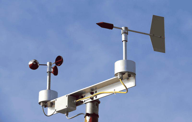

mw11 said:
The funnel (lets say inlet diameter 18", 20 degree reducing to 2" outlet) spins freely to capture the prevailing wind (fluid is air, wind speeds of 10 - 20 mph).
Wait, you mean like an anemometer?
https://www.thoughtco.com/history-of-the-anemometer-1991222
The concept of the anemometer is similar; however, put a funnel on the one end, add a hollow stem, and check valve. If it helps, the objective is to inject air (wind assisted, very low flow) through a check valve (trying to figure out design parameters) and into the soil column.
