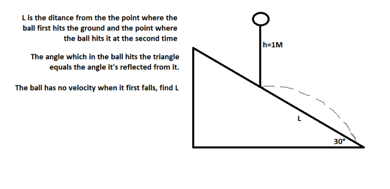

Eitan Levy
259
I wrote equations for the vertical and horizonal distances, but I still wasn't able to find L (was missing an equation).
Is it possible?
Is it possible?
You need to show us how far you got.
As I see it, given the information, the ball can only land in one position, so it must be possible to solve the problem.
PS I think you are supposed to assume energy conservation from the angle of incidence being equal to angle of reflection.
You'll need to provide the details of your work.
It's certainly possible to use kinematic equations to find the result. The acceleration due to gravity is a constant value, hence the constant acceleration kinematic formulae all apply (SUVAT).Edit: Ah! @PeroK got there ahead of me!

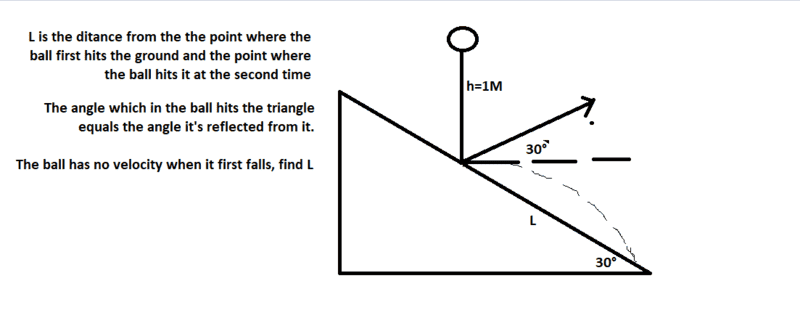

First we can know this:
Now let's say that the ball leaves the surface with a velocity equals to V.
We can say that:
Lcos(30)=Vcos(30)t
-Lsin(30)=Vsin(30)t-5t2.
We see at the end that V=5t, and that L=0.2V2.
We also know that the ball hits the surface with a velocity of √(20), all vertical.
Now I am stuck.

We solved this problem in class before we studied energy, so my teacher either used it to introduce the topic to us or solved it without it.
We can say that:
Lcos(30)=Vcos(30)t
Now I am stuck.
You can use the first equation to find an expression for ##t##. You can substitute that along with the known values for sin(30), cos(30), and V into the second equation to yield an equation with only one unknown, ##L##.
Didn't you use energy considerations if you assumed that the velocity stays the same after the ball hits the surface?
We can say that:
Lcos(30)=Vcos(30)t
Now I am stuck.
I think you've almost got it. You have:
##L = 0.2 V^2##
I assume that is with ##g =10m/s^2##.
And, you have got ##V = \sqrt{20} m/s##
So, that's it isn't it? It bounces off the triangle with the same speed ##V## as it hit it. Just in a different direction.
##L = 0.2 V^2##
What I am asking is how you know that the velocity stays the same after it hits the surface.
Two reasons. 1) That's a property of angle of incidence = angle of reflection. 2) If you assume variable ##V## after the bounce, then the problem can't be solved! ##L## would depend on a thing called the coefficient of restitution.
Alright, thanks a lot.
In a way, yes: I made the practical assumption of it being a perfectly elastic collision. There was nothing in the problem statement that would suggest otherwise. See also @PeroK 's response.
To expand a little on @PeroK's reply...
Consider the impact velocity in components normal and parallel to the slope. The impact creates an impulse on the ball normal to the slope, so does not affect the velocity parallel to it. Since the angles are equal, the ratio of the magnitudes of the velocity components remains the same, so the velocity normal to the plane must stay the same magnitude but swap sign.
