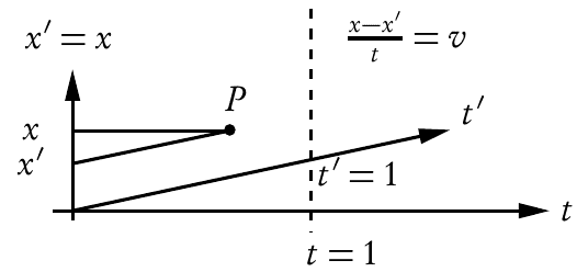

A rotation matrix has (at least) one real eigenvalue 1 and a real eigenvector, giving the direction of the rotation axis.
I was also struck by his statement "none" for eigenvectors of the Euclidean rotation, since there is as you point out an eigenvector constituted by the rotation axis, which (I understand) is the line passing through the fixed point of the rotation, i.e. visually, a line perpendicular to the page where we paint the 2D rotation, right?
But note that in the image that I copied in post #25 from robphy's paper he himself does mention an eigenvector for the Euclidean rotation with coordinates (0,0), corresponding to such perpendicular line?
And another interesting point is what would be the eigenvector of the Galilean boost? In this discussion he mentioned "infinite speed" while in the said paper he mentioned "time". I said that I prefer the second option, although I am not sure if eigenvector would be in this context the accurate term or we are talking about an analog of it.
I think that a parenthesis to clarify this subject would be useful, as it is relevant to the main issue.

The null vector never is an eigenvector of any matrix. Because trivially ##\hat{A} \vec{0}=\vec{0}## for any matrix ##\hat{A}##.
As I said, for me these pseudo-4D extension is just a convenient way to realize all Galilei transformations (including Galilei boosts) by ##4 \times 4##-matrix multiplications, but that's all there is to it. It doesn't add any additional structure to the description of Galilean spacetime than is already there when interpreting it as a fiber bundle, which is the natural choice for the Galilei-Newton spacetime.
Concerning the Galilei boost, let's to for 1D motion. Then the "vector" is
$$\vec{x}=\begin{pmatrix} t \\ x \end{pmatrix}$$
and the boost is described by
$$\vec{x}'=\begin{pmatrix} t \\ x-v t \end{pmatrix}=\begin{pmatrix} 1 & 0 \\ v & 1 \end{pmatrix} \begin{pmatrix} t \\ x \end{pmatrix}.$$
This "Jordan matrix" has only one eigenvector ##(0,1)^{\text{T}}## with eigenvalue ##1##, which simply tells you that at time ##t=0## all the points on the ##x## axis are unchanged by the transformation, which is, however trivial anyway.

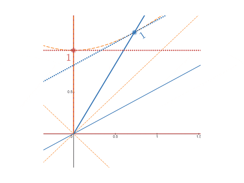

The context of this discussion (starting from the OP and the link to eigenchris's YouTube video) has always been on a two-dimensional plane,
and when I joined, I brought up the Cayley-Klein approach
with the parameter E to move between
the Euclidean plane, the (1+1)-Galilean diagram, and the (1+1)-Minkowski diagram.

In relativity, we have null-vectors (nonzero vectors with zero dot-product with itself)
that are not the zero-vector.
This Galilean-boost eigenvector corresponds to the limiting infinite speed (infinite slope) of all Galilean-timelike vectors,
similar to the Lorentz-boost eigenvectors corresponding to limiting [finite] velocity of all Minkowski-timelike vectors.
update: The Galilean boost eigenvector also happens to correspond with the concept of "absolute time" because this eigenvector is along the Galilean-circle. Since all tangent vectors to the Galilean circle are parallel, all Galilean observers agree on those events being simultaneous (since the tangents to the circle for each Galilean-4-velocity are Galilean-orthogonal to that 4-velocity).
This is unlike the situation for tangents to a circle (in 2D Euclidean space) and tangents to a hyperbola (in (1+1)-Minkowski spacetime).
The Galilean eigenvalue of 1 means that all Galilean observers will agree on the magnitude of displacement vectors parallel to ##(0,1)^{\text{T}}##. Physically, all Galilean observers agree on the length of a ruler. This is "absolute length".
Many results in Galilean geometry are trivial... and since much of the physical interpretations are part of our "common sense", it is difficult to generalize to the non-trivial case without guidance.

and now see a way to formalize the analogies and
visualize them with (say) desmos ( https://www.desmos.com/calculator/kv8szi3ic8 )...
so that they are not just cherry-picked...
but that they follow from similar constructions in the three geometries.
So, the reframing is to help build on what one knows (but likely from a different viewpoint)

For Galilean relativity, with its Galilean circle ( the "t=1" line),
all tangent lines coincide. So, if an observer says two events are simultaneous,
then all other observers will agree.
This universal agreement is absolute simultaneity...
and is a peculiarity of the E=0 case. Among the E-parametrization of geometries,
the Galilean situation (our common sense) is the exception, not the general rule.
To appreciate this, here is an animation from my spacetime diagrammer ( https://www.desmos.com/calculator/kv8szi3ic8 ),
showing the cases for E varying from -1 (Euclidean) to 0 (Galilean) to +1 (Minkowski)
(if the above isn't animated, visit https://i.stack.imgur.com/d8q62.gif
which is taken from my answer at https://physics.stackexchange.com/questions/673969/euclidean-space-to-minkowski-spacetime )Because of this universal agreement of simultaneity,
we can slice up spacetime into universally accepted hyperplanes of simultaneity,
which can be labeled by any observer's wristwatch.
This universal labeling by a wristwatch (a scalar) is absolute time.
The relativity-principle says that there is no preferred wristwatch,
no preferred 4-velocity vector (no timelike eigenvector).
(Note that each choice of 4-velocity will
"bevel the deck" of hyperplanes-of-universal-simultaneity differently,
which effectively assigns the same value of the y-coordinate
to events parallel to the 4-velocity.)
...From my ancient set of webpages on relativity
(now archived at http://visualrelativity.com/LIGHTCONE/ )
Bottom line:
  • Observer-Wristwatch-time is a scalar.
  • Observer 4-velocity for the observer-time-axis is a vector.
