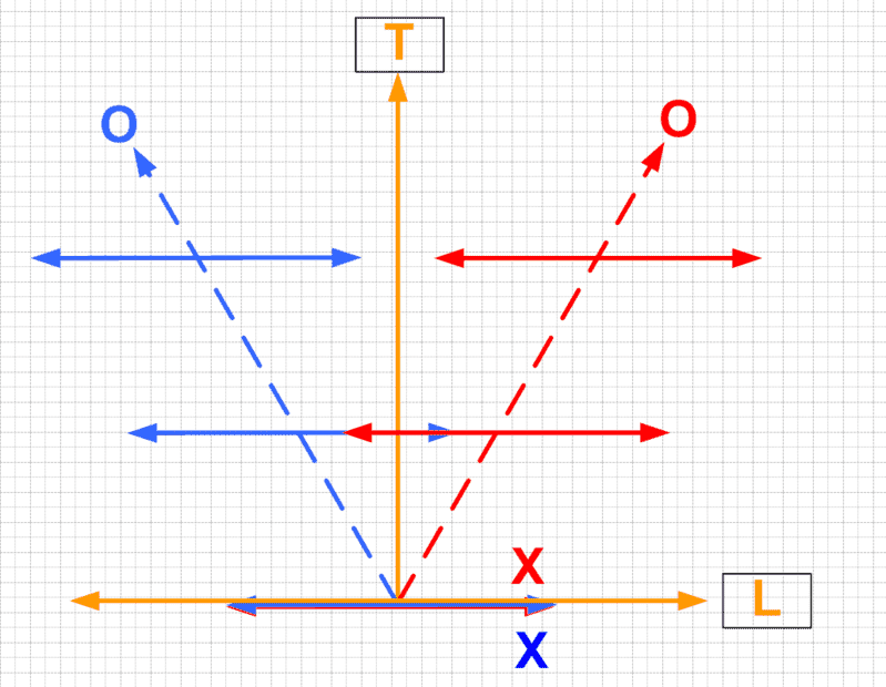

  • #61
robphy said:
The eigenvectors of the boost should primarily be about maximum signal speeds.
So, if I were to redo that poster,
I would say "absolute maximum signal speed is infinite" instead of "absolute time"
for the ##(0,1)^\top## eigenvector of the Galilean boost.
And the eigenvectors represent limiting the possible 4-velocities (future-timelike directions)
in the Galilean case, as the lightlike eigenvectors in (1+1)-Minkowski spacetime.
(Note that the ##(0,1)^\top## eigenvector of the Galilean boost is also a null vector with respect to the temporal-Galilean metric. Together with the discussion below about absolute time,
this means that ##(0,1)^\top## is both null and spacelike in Galilean geometry,
as a result of "opening up the light cones" from the Minkowski case).The notion of "absolute time" is really about
different frames of reference agreeing on what sets of events are simultaneous.
Further thoughts on the same subject, in the line of relating the Galilean eigenvector to an infinite speed.
You cannot define it as a speed, just like you don't define it as the speed of light in SR. It must be a displacement vector composed of x and t intervals. If it travels instantaneously, it means that, despite employing t = 0, its x is everywhere. Would it then make sense to define it, not as ##(0,1)^\top##, assuming that x = 1, but as ##(0,x)^\top##, assuming that x is everywhere? (note that in fact, in the derivation of the eigenvalue, x was the X coordinate of "a certain vector"; we can assume that it was a unitary vector, but that is an assumption; understanding now what it means, I would leave the x).
Also, it is to be noted that in SR the eigenvectors are the lightlike vectors going in each direction, X and -X. Here, instead, we have only one Galilean eigenvector. This may imply that its expression is telling you precisely this: "don't see me as a vector that is somewhere, looking either left or right, but as one that is everywhere at the same time".
In conclusion, this is what I would understand from your development, in terms of eigenvectors / eigenvalues:
eigenvectors:
- just like Minkowskian observers have a finite speed instrument with which they fix lengths and synch clocks (actually 2 instruments, one going in each direction), Galilean observers have also an infinite speed instrument for the same purposes;
- in agreement with its nature of eigenvectors, these instruments remain on their respective lines despite boosts and this requires that they keep the same correlation between x and t, i.e. the same speed, either a finite or infinite one, as the case may be: in the Minkowskian case this has the simple reading of the same correlation between t and x, in the Galilean case what remains invariant is the statement "I am a vector that in no time can reach everyhwere";
eigenvalues: in the Galilean case, the eigenvalue = 1 entails that the scale is maintained and objects keep their lengths and clocks keep their time rates and remain synched, whereas in the Minkowskian case we only manage to keep the invariance of the speed of light at the cost of a dilation and a change of scale, the change of scale being given by Doppler-Bondi factor and being reciprocal, so that each frame sees the other as "out of scale" (and hence length-contracted, time-dilated and de-synched).
Would you agree to this para-phrasing of your points?

  • #62
[ snip]
I think you have mostly got it.
However, these passages sound contradictory (word-coloring by me)
... [snip] ...
eigenvectors:
- just like Minkowskian observers have a finite speed instrument with which they fix lengths and synch clocks (actually 2 instruments, one going in each direction), Galilean observers have also an infinite speed instrument...
I would describe an eigenvector of the (1+1)-Lorentz-boost
as having a velocity-magnitude of "the speed of light".
This speed is not attainable by any future-timelike vector,
although a sequence of repeatedly-boosting a future-timelike vector tends to it.
This is in analogy to what I said in #47,
where an eigenvector of the (1+1)-Galilean boost
is not attainable by any future Galilean-timelike vector,
although the sequence of repeatedly-boosting a future Galilean-timelike vector tends to it.
I describe that as an infinite speed (although I don't want to get into discussions about infinity).
At this point, I'm more concerned with what the mathematical structure implies
in terms of describing the physics and less concerned about what the structure is called.
(Since I recently re-watched on YouTube Feynman's The Pleasure of Finding Things Out....
this made me think about the passage about "knowing the name of something".)
By the way, one could describe the finite speed of light eigenvector in the (1+1)-Lorentz boost
by an infinite rapidity, not attainable by a timelike vector, but it is an upper bound.
The Galilean rapidity associated with its eigenvector, not attainable by a Galilean-timelike vector,
is also infinite.
In terms of coordinates, in light-cone ##(u,v)## coordinates,
where frontward-future eigenvector is ##(1,0)## with finite speed,
nonzero timelike-vectors can't have one of these coordinates as zero.
Similarly, in ##(t,x)## coordinates, where the eigenvector is ##(0,1)## with my "inifinte" speed,
nonzero Galilean-timelike-vectors can't have the t-coordinate as zero.
In the business of extending an idea by a specific set of analogies,
we sometimes have to loosen the traditional definition of a word.
At this stage,
I am happy calling the Galilean-eigenvector ##(0,1)^\top## an "infinite" speed
because I can and have used the mathematical construction to make progress toward
formalizing the analogies and connecting them to the physics.
There may be a better term.
But in my current intuition, I think of velocity as a slope.
On occasion, in Euclidean geometry, I may have a vertical segment,
where one has a similar issue with the "slope" of a vertical segment.
How one handles this situation could be how we should handle the description of ##(0,1)^\top##.

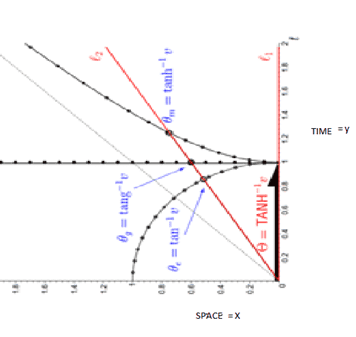

Saw said:
Would it then make sense to define it, not as ##(0,1)^⊤##, assuming that x = 1, but as ##(0,x)^⊤##, assuming that x is everywhere?
An eigenvector is really a direction, a slope (if I am permitted an extension on the term).
When ##(0,1)^⊤## is an eigenvector ##(0,17)^⊤## is also an eigenvector. And, of course,
they have the same eigenvalue.
The discussion of the eigenvector-eigenvalue table and its interpretation from my poster
has been useful. It helps me address issues that may be unclear, which would help
when I present these ideas in a talk, a poster, or a paper.
...but the "eigenvectors and eigenvalues" concept is only the tip of the iceberg
of the Galilean spacetime (which was introduced by the eigenchris video you linked in the OP).
What is more interesting and more useful is
how well it can describe Galilean physics
(as a stepping stone as to how well Minkowski-spacetime geometry
can describe [Special Relativistic-]Spacetime physics).

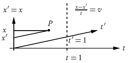

  • #65
Saw said:
Surely it is and we have to come back to the issue of time as a vector vs a scalar, but please let me say a couple of things more on the eigenvector subject, because this is a little like the foundation of the building.
How often do I have to repeat this! There is no single physical theory, where time is a vector!!! It's a real oriented parameter parametrizing the causal order of things.
In Newtonian mechanics it's just a real number, and at each point in time there's a 3D Euclidean affine space, i.e., Newtonian spacetime is a fiber bundle, at least that's the natural mathematical structure depicted closest the physical meaning of the Newtonian spacetime model, not these artificial "Newtonian four-vectors" we are unfortunately still discussing and which obviously are very confusing for you.
In SR spacetime is described by a 4D Lorentzian (pseudo-Euclidean) affine manifold. Choosing an inertial reference frame can mathematically be defined as choosing a space-time origin (the arbitrary event, we label with ##t=0## and ##\vec{x}=0##) and a Lorentzian basis (tetrad). Then the corresponding "coordinate time" is the time-component of the four-vector wrt. this choice of (global) inertial reference frame. Another much more convenient choice of time is a scalar, depending on the physical situation you want to describe. E.g., if you do special-relativistic point-particle mechanics for a single particle (maybe moving in some field, like an electromagnetic field) a convenient choice for the time parameter is the particle's proper time, which is a Lorentz scalar, parametrizing the worldline of the particle.
  • #66
I have no problem with Newtonian time as a real number. That was the point of the OP: that the video showed a "time basis vector" that seemed incompatible with Galilean relativity and not the good way of introducing SR, as it implied that you will find in the latter what already exists somehow in the former. I must say however that the discussion is being very productive for me.
Ah, but here you are pointing out that my understanding of SR is wrong. Maybe! The thing is that I have seen a few descriptions of SR in terms of linear algebra, with the LT presented as a change of basis and the basis vectors being (putting t first and x later and assuming just one spatial dimension) a unit spatial vector (0,1) and a unit time vector (1,0), the combination of which (with the specific metric of SR where the dot product has minus sign) gives a spacetime interval as distance between two events.
In fact, if we talk about a four-vector (a 2-vector if we restrict ourselves to T and X), the time-component that you talk about must be a vector as well: a coefficient multiplied by a basis vector. This coefficient will be "coordinate time"... or "proper time", if the interval in question happens to be timelike and the inertial reference frame that we are talking about also happens to be present at both events of the interval. But... if I look at the Euclidean analogy, there may also be situations in which one frame has one single axis linking the two extremes of the distance. For example, you may measure the height of a tree with an X axis paralell to the ground + an Y axis parallel to the tree, whereas my X axis is a ladder leaning on the top of the tree. So your solution comes from the combination of two coordinate values, while mine flows from a single proper value. With regard to another problem, it may be the other way around. But because of this, we don't stop saying that the basis vector of X axis is a vector.
Also note that there is proper length as well, and because of this we don't stop saying that there is a space basis vector.

What prevents it? Why do you need a time-basis vector for this? Do you rather mean that if I draw my vertical line perpendicular to my X axis, then yours must be inclined? Sure, but this has nothing to do with the time axis. You don't need to attribute this different inclination to any observer dependency in terms of time. You just have to admit that the different evolution over time of the origins of the frames reflects their progressive spatial separation.
See this image which I posted before, now improved on the basis of our discussion on eigenvectors, where the vertical (absolute time) and horizontal (absolute length) orange axes reflect the common scale arising from eigenvalue = 1.

I am going to argue that the structure is already there, as part of the position-vs-time diagram.
As soon as you write down the Galilean transformations in matrix form,
you are working with Galilean vectors, with time and space components.
That's what the Galilean transformation does...
it maps a Galilean 4-velocity to another Galilean 4-velocity.
But you seem unhappy with that.
So, let me not use the word 4-velocity, since I think it is a distraction at this stage.
let's use instead "unit tangent vector" and think of it as a unit displacement .
So, a Galilean boost transformation maps a unit tangent vector (of an inertial worldline)
to another unit tangent vector.
That's what this diagram shows---making the tilted tangent vector vertical.
(No need to mention or invoke 4-velocity.)
(The fact that the horizontal lines (hyperplanes) are unchanged is irrelevant
to the transformation making the tilted tangent vector vertical.)

For me, in my Spacetime Trig approach,
I can prove many kinematical results in special relativity
by direct analogy with Euclidean geometry via
a one-parameter family of Cayley-Klein geometries
from E=+1 for Minkowski to E=-1 Euclidean, where E=0 is Galilean spacetime geometry,
which is the topic of the eigenchris video linked in the OP.
My participation in this thread is my response to the OP,
which questions the usefulness of the Galilean spacetime.
I think the value of the approach is that many of the surprising results of SR (special relativity)
can be shown to have a "Galilean limit" precisely,
and seems to suggest the Galilean-spacetime version
and Euclidean-geometric version of the special relativistic result.
This suggests that the result might not be as "How could that be?"-surprising
if one was already
aware of the Euclidean and Galilean versions...
or one might be able to use Euclidean and (if illuminated) Galilean versions to obtain the SR-result.
It's not just about such analogies in a few situations,
as seen in scattered throughout the literature
as if one chose (possibly because one already knows the answer for this situation)
which term would be subjected to the limit.
Rather, it's a unified approach that dictates which terms are subjected,
due to a parameter in the Cayley-Klein approach (at the level of its projective-geometric foundations).

It is useful to find a quantity to describe how different these two tangent vectors are---
something to describe the separation between their directions.
In Euclidean geometry, we use "relative angle" and we use "relative slope"=tan(relative angle).
In Minkowski geometry, we use "relative rapidity" and we use "relative velocity"="relative slope on the diagram"=tanh(relative rapidity).
It turns out (in the literature I referenced earlier, and in my poster) in the Galilean geometry,
we use the relative Galilean-rapidity, and we can calculate a "relative slope",
which is proportional to the rapidity (as opposed to a nonlinear relation because of tan or tanh).
Thus, the "relative spatial velocity" between the moving clocks can be obtained
using the two tangent vectors.
This relative velocity determines the "v" in the Galilean boost to transform from Alice's frame to Bob's frame.
That seems like a useful physically-interesting quantity.

  • #85
Saw said:
In all cases, the tangent of the "angle" is the slope" o ratio between the relevant values: a purely spatial ratio = x/y (in the Euclidean case) or a spacetime ratio = x/t. i.e. a velocity (in the Galilean and Minkowskian cases).
Please confirm if I reflected it well.
Yes, in your rotated-axes convention (following space-running-horizontally, time-running upwards).
In my poster, I keep the time-axis horizontal (as in PHY 101 texts) and refer to the spatial-direction as y
in order to make comparisons with Euclidean geometry and intro (Galilean) physics easier.
(However, it could be argued that familiar "angle" as arc-length-on-unit-circle
isn't as natural as construction as the associated "sector area"-intercepted in unit circle.)
Saw said:
In my naive understanding, the time basis vector should be the unit of the time axis and this in turn the output of a clock
I would agree with this, provided that this is
the unit tangent-vector to the worldline for any clock (whatever its motion and in whatever case (SR or Galilean)).
Even if a symmetry exists (like absolute time)​
that suggests that
each observer can give-up his or her clock​
(as if surrendering a democratic right [the principle of relativity])​
in favor a universal (autocratic absolute timekeeper) Big Ben to tick for the universe,
the unit tangent vectors to various worldlines can and should​
still function as [possibly viewed by some as redundant and useless] time-basis vectors.
(In surrendering, the ability to understand relativity in hindered...​
"do you mean we each can really keep our own time with our own watches?" )​
I am keeping the focus on the unit tangent vector, but that is what the geometrical analogy dictates.
In special relativity, one can interpret that unit tangent vector as the so-called 4-velocity (geometrically, a dimensionless quantity [since it's a unit-vector], despite its name and despite its historical introduction),
where the ratio of its sides [in (1+1)-spacetime] is the dimensionless version of the more-familiar "spatial velocity" v appearing in the boost. But these aspects appear to provide a distraction from the main issue.
So, I have and will continue to avoid it... because I can support my viewpoint that time-axes are associated with the unit tangent-vector of every clock worldline.

  • In a PHY 101 position-vs-time graph, a Galilean circle
    (the set of events from a reference event that occur "1 second later" according to wristwatches that were at that event and can travel inertially with any velocity),
    as revealed by experiments done at terrestrial speeds and extrapolated to arbitrarily large speeds,
    has the form ##t^2+(0y^2)=R^2##
    (where time ##t##-axis is parallel to the inertial wristwatch worldline and the spatial ##y##-axis is perpendicular to that worldline
    (where perpendicular is parallel to the tangent to the circle)
    and ##R## is the wristwatch reading).
  • In a Minkowski position-vs-time graph (a spacetime diagram), a Minkowski circle
    as revealed by experiments done at terrestrial speeds and high-energy particle speeds,
    has the form ##t^2-y^2=R^2##
  • So, a Galilean might have said "a generalize circle has the form
    ##t^2+(k) y^2=0##, where ##k=1## for Euclidean and ##k=0## for Galilean.
    And there are many similarities (and differences) between the equations
    and the geometrical constructions.
  • But then (newsflash)
    experimental data (from unstable high-speed particles that should have decayed)
    says that for position-vs-time graphs is seems that ##k\neq 0## , in fact ##k<0##!
    For some convenient choice of units, a curve-fit gives a value of ##k=-1## ,
    which implies there are asymptotic speeds for wristwatches that are finite.
    This ##k## is ##(-E)## in my past discussions in this thread ( and ##-\epsilon^2## in my poster).
    (Again this is along the lines of
    If Maxwell had worked between Ampère and Faraday: An historical fable with a pedagogical moral
    https://aapt.scitation.org/doi/10.1119/1.12239 .)
So, it is a good thing that
the Galilean space-time plane is not a Euclidean affine space (neither is the Minkowski space-time-diagram plane)!
a very good thing.
