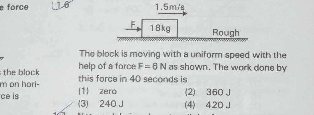

Let's say 2 forces are acting on the object of same magnitude in opposite directions then net force is 0 but their is some constant velocity then after some time there will be some displacement due to velocity. Now if we want to find work done by individual force how can we calculate it because in this formula F.d the change in velocity square is included which will increase amount of energy transferred to object exponentially.
Well, the energy does not increase exponentially, it is increases quadratically with respect to speed. However, at a constant speed (with some opposing force) that goes away and you are left with a transfer which is simply linear with respect to distance.
This is exactly the correct behavior. Suppose that you are pushing a block over a rough surface at constant speed, so the two forces are your pushing force and the friction force. The energy depends linearly on how far you push, so the power required is higher the faster you are pushing (linearly with respect to velocity). Intuitively that should make sense from your own experience pushing things along rough surfaces.
You are confusing yourself with contradictions. In that one sentence you say "constant velocity" and "change in velocity". Are you confusing change in displacement with velocity?
In your example of two cancelling forces, the net force is 0 and the acceleration is zero, and the net work is 0. That is true no matter how big the two forces are as long as they add up to 0. So no, given those parameters you can not calculate the work done by each individual force; you don't know how big the forces are.

I wanted to found work done by individual forces not net.
I was doing the question which I attached with this post then this query came to my mind.
Okay I agree 💯,
this was the thing I wanted to say. So then we can't use the formula F.d
Certainly, we can. That is how we know that the work is linear with distance (and therefore the power is linear with speed).
Thanks!
Work is linear so that's why to increase the speed by a unit we have to cover distance in proportion to increase in kinetic energy because work is linear with distance.
