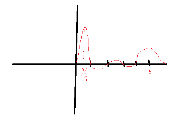

The strategy does not always work. I think what you are suggesting is that you should find the real-valued maximum and use that. It will not give the sup if the maximizing x is not an integer. Perhaps you think that you can look at the integers immediately above and below the real maximum, to find the integer maximum. Often this works (and it *does* work in this case), but IT CAN FAIL: it is perfectly possible to devise examples where, eg., the real maximum is at x = 2.5 but the integer maximum is at x = 50.
vanhees71 said:
This I don't understand. Can you really give such an example?
See
Now it's clear that use of differentiation to find Sup(A) or Inf(A) isn't a proper way, then what are the proper steps of finding Sup(A) and Inf(A) rather than assuming natural numbers to x ?
