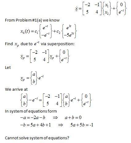

Determine the non-homogenous solution of the given differential equation.
See 3.
I have solved for the homogenous part, but as you can see in the link I am getting an unsolvable system of equations with the substitution method on the non-homogenous part. What am I doing wrong?
You have to choose an other trial function for xp, as the inhomogeneous part contains the same exponent as one of the exponents in the homogeneous part.

Try
<br /> x_p = a\begin{pmatrix} 1 \\ -1 \end{pmatrix} te^{-t} <br /> + b\begin{pmatrix}1 \\ -5\end{pmatrix} e^{-t}<br />
