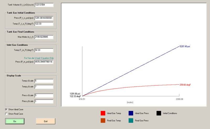

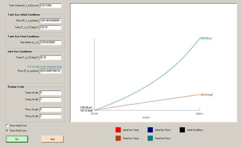

Update:
FINALLY got my code running now. I forgot to switch my VdW constants over to ##ft^3, atm, mol## units. Took me a while to track it down via process of elimination.
At any rate, I find it interesting that the curves for real gas vs. ideal gas show that they are switched relative to which ones are linear. For the real gas, temperature was linear, and pressure rose non-linearly. For the ideal gas, the situation was reversed.

It's got to be just a coincidence. Try the calculation with a and b halved and see how the shapes of the curves compare.
You're right:
I also tested for pressures down in the ideal range, and both the ideal and real curves were almost coincident, which is what would be expected.
