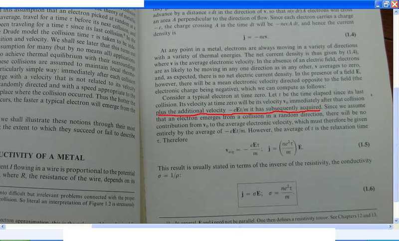

Cant understand this line in the book(semiconductor nightmare 4)
  • Thread starter Thread starter nhrock3
    Line

in the marked red line
how they comeup with the fact the the velocity increases by this amount
i didnt see this expression before in this book
Hi nhrock3! :smile:
F = ma = m(dv/dt) …
In this case, F = qE = -eE, so m(dv/dt) = qE, so ∆v = -eEt/m. :wink:
