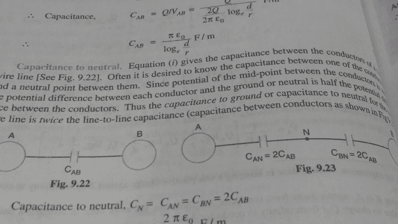

In the book they've derived the formula as:
Textbook page with formulas for capacitance of a two-wire line, C_AB = Q/V_AB = 2πε0 / log_e(d/r) F/m, followed by diagrams: Fig. 9.22 shows conductors A and B with capacitance C_AB between them, and Fig. 9.23 shows A, neutral N and B with C_AN = 2C_AB and C_BN = 2C_AB.
So as per the book formula the factor of 2 must be there.

Your book clearly derives CAB without the factor of 2.
The confusion arives because your problem uses "neutral" as the second, not the third, wire. There is no third wire.
The example on that website calculates the capacitance between two wires that have opposite polarity eg when one is positive the other is negative. It then modifies that equation to give one for the capacitance between either wire and a virtual neutral mid way between them.
Your situation is different. In your case one of the wires is neutral not the opposite polarity. So the neutral point in your case is physically twice as far away from the line as their example.

The book gives the distance between "A" and "B" conductors and shows an "N" conductor half way between them. It then asks for Capacitance between a main conductor (A or B) and "N".
What happens to the capacitance between conductors when the distance between them changes?
The capacitance increases when the distance between plates/wires reduces.

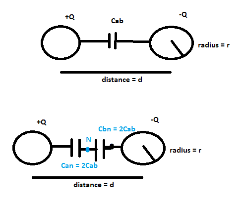

I'm still not getting it. This is what the book page says:
Consider a single phase overhead transmission line consisting of 2 parallel conductors A and B placed d metres apart. Let their respective charge be +Q and -Q C/metre length.
Diagram of two parallel circular conductors, the left labelled +Q and the right labelled -Q, with radius = r on the right conductor and distance = d marked between their centres.
CAB = 3.14(permittivity)/log(d/r) F/m
Now for Capacitance to neutral:

Two schematic diagrams of a two-wire line: top shows +Q and -Q conductors (radius = r, distance = d) joined by capacitor Cab; bottom adds a neutral point N between them, with Can = 2Cab and Cbn = 2Cab.
There is no separate neutral wire. The Neutral is a point at zero potential and Can = 2Cab. In the main question posted in post#1 they are asking to calculate line to neutral capacitance. And they are saying a single phase line has 2 charged conductors. So one would be +Q and the other -Q. Just like in diagram above. I'm really confused. There is one solved example but that requires to calculate line to line capacitance and they've substituted formula Cab.
