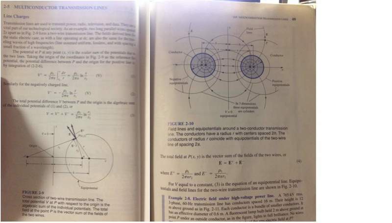

https://www.physicsforums.com/attachments/66302Two-conductor transmission line, find the potential difference V of the two conductors.?
Two-conductor transmission line. At point P (x=43 cm, y=32 cm) in Fig. 2-10, |E|=450 V/m. If s=25 cm, h=29 cm, and r=12.5 cm, find the potential difference if these two conductors.Ans. =1.13 kV independent of permittivity of medium.

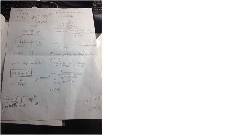

I having trouble starting this problem. My worki is attachedhttps://www.physicsforums.com/attachments/66304
Thanks for any help in advance.

Hey guys. I attached my work to this problem before but it didn't go through so here it is. It's ATTACHED. I also included so information from the textbook. if anyone has any ideas please let me know. Also I even asked my teacher and he said the answer I should be getting is the one that is boxed in. He says the book is WRONG. Either way I'm not getting either answer.
