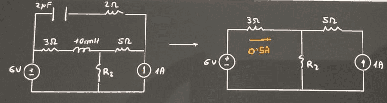

In the circuit of the figure, determine:
a) ##R_2##, ##v_c##, ##v_0## and ##v_F##.
b) ##R'## to be connected in series with ##R_2## so that the voltage source neither yields nor absorbs power.
Capacitor: open circuit.
Figure:
My attempt at a solution:
Once the capacitors have been applied, we see directly that ##\boxed{v_c=v_0=0\, \textrm{V}}##
Wouldn't this one be done like this?
I know the following: in a circuit with capacitors and coils, if we have
  • Capacitor: we change for an open circuit.
  • Coil: we change for a short circuit.
I don't know if the capacitor didn't act as an open circuit while charging and once charged as a short circuit?

Once the capacitors have been applied, we see directly that vc=v0=0V
That's not what I see. Please explain your reasoning.
Because with these notes we were left with an open circuit:
So there is no intensity, right?

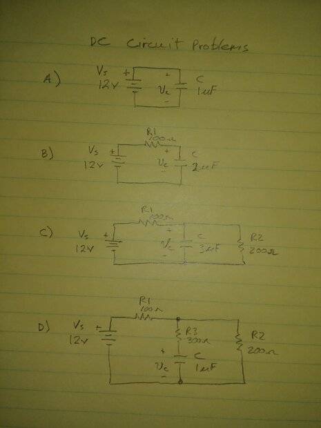

No. You can have a constant (DC) voltage across a capacitor. You can have a constant (DC) current through an inductor. Redraw your schematic with the changes you proposed and solve it, don't assume the solution.

Try each of these DC analysis problems. In each case solve for the capacitor voltage. Let me know if any confuse you and why, if possible.

OK in my problem A), what is the voltage across the capacitor if you remove the capacitor by replacing it with an open circuit (i.e. no connection).
But how is this voltage calculated?
In the first ##v_c## it would be ##12##, wouldn't it?
In the second it would be ##12-V_{\textrm{resistance}}##
The c would be ##v_c=0##, wouldn't it?
And d I would say it would be ##12-V_{\textrm{res 100}}-V_{\textrm{res 300}}##
I would say it's like that, but I have no idea...
Vc = Vo = 0, means that if you put a voltmeter across the terminals of the capacitor, or across the terminals of the resistor, the voltmeter will register 0v. Which of course subsequently means that both terminals are at the same potential.
If that is the case( which it may or may not be - to be determined ), the solution is quite easy.
It is given to you by the voltage source (battery). You don't calculate it. A voltage source, by definition, will do whatever it takes, by sourcing or sinking current, to make the voltage at its terminals equal to the definition given; 12V in this case.
Guillem_dlc said:
In the first vc it would be 12, wouldn't it?
Yes. See above comment.
Guillem_dlc said:
In the second it would be 12−Vresistance
Yes. So what is Vresistance? What information do you need to find the voltage across a resistor?
Guillem_dlc said:
The c would be vc=0, wouldn't it?
No.
Guillem_dlc said:
And d I would say it would be 12−Vres 100−Vres 300
Yes. But now you'll have to understand how to find the value of those voltages across the resistors.
