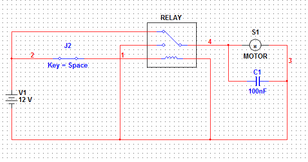

There are two solutions to this.
1) The Electronic Solution
You can use a SPDT relay (Single Pole, Double Throw or "two-way switch" relay) to short the motor by having the relay switch between the +ve rail and the other contact of the motor. I've attached a schematic of the circuit.
2) The Mechanical Solution
Connect a worm gear to the motor, then run a cog of that to drive the wheel. The wheel will move more slowly, but will have a lot more torque. The wheel also cannot be turned by hand, and will stop dead when the motor stops turning. For optimum turning I'd suggest a tri-state system:
Moving forward = both motors full on.
Turning left = right motor on full, left motor 25% voltage.
Turning right = left motor on full, right motor 25% voltage.
Stopped = both motors off.
This allows for a smoother movement, puts less strain on the mechanical parts and saves battery power (motors have a lot less friction to contend with).
To be honest I'd stick with the electrical solution, but it's up to you.
