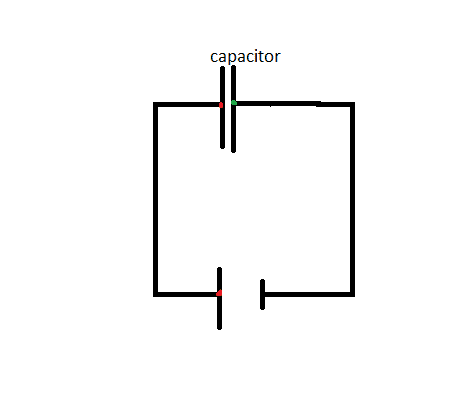

hmm yes, so you get like a quasistatic situation. But I don't think it's very obvious though. So say we have a simple circuit like the below. The platecapacitor is connected to the battery with wires, which are of course also conductors. Since the wire and plate is an equipotential does that then mean that the line integral of the electric field from either of the red dot to the green dot is the same?

Yes. Remember, there is an electric field inside the battery which is maintained by electrochemical processes.
Yeh okay, I understand what you are saying. The problem is for me that it is kind of a contradicting to say that the work done on the charges in moving inside the conducting part of the circuit is zero since the field inside it is zero - because the charges are moving exactly when the field is not zero as to yet again establish a field equal to zero. And shouldn't this motion give rise to some extra energy, which is not included in the model where you say that the only place, where there is an actual field is inside the battery.
