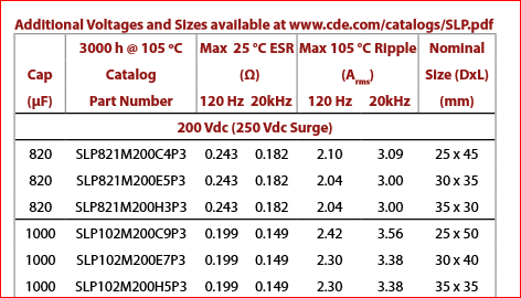

what if a combination of 4 caps in parallel each having 1000uF has a given ESR , and then another combination of 6 x 820uF caps again have that same ESR , also all other ratings are the same and matched except the capacitance is bit higher in the second case , which arrangement would be better then ?
Also if two caps are in parallel and each cap has a ESR rating of for example 150 miliOhms then the total ESR of those two caps will be 150 divided by the number of caps which is two and the total would then be about 75 miliOhms ?
and another thing I wish to know is when adding caps in parallel the individual ripple current ratings of each cap add up correct? So if one cap has a max rating of 2A then two such caps in parallel would be able to have a max of 4A?P.S. If I think correctly about the ESR then apart from other parameters one of the more important ones for low ESR is total plate area of all caps in parallel and how easy the charge can get to distribute across that area? So theoretically the question whether more caps in parallel equal less ESR is hard because on one side the total are increases and the distribution maybe is more even but on the other side each cap has pins and soldering points etc that adds up more resistance , well I'm not sure.

see what you think of these, maybe five bucks apiece
http://www.cde.com/resources/catalogs/SLP.pdf
http://www.digikey.com/product-deta...ronics-cde/SLP102M200H5P3/338-1454-ND/1881931
"Better" is subjective... do you count the aesthetics of how it looks and difficulty of mounting?
With filter caps the old adage "more is better" points to your second choice.
If the caps are worked hard, ie lots of ripple, there may be some advantage in heat dissipation from the increased surface area of several caps.
Ohm would not disagree with that, neither would i.
yes, so long as nothing in your layout causes current to divide unequally. So keep interconnecting wires short and stout.

CDE type SLP datasheet gives values for both ESR and ripple current .
