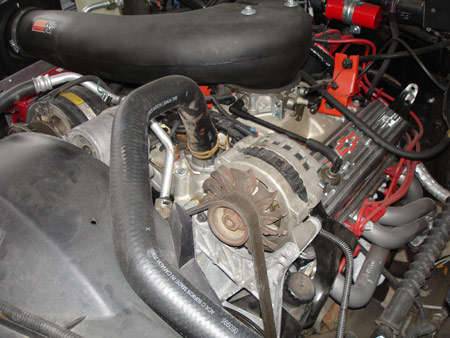

Here is a picture of a car engine. The alternator is the part spun by the rubber belt.
