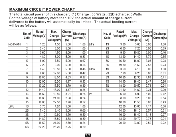

I think karabiner does not have a thorough grasp of the difference between power and energy.
Here's a snip from the Imax user manual at http://www.ittgroup.ee/files/IMAX_B6_manual.pdf
Comparing a 50 watt battery charger to a kilowatt automobile alternator is like comparing a sled dog to a Percheron draft horse.
Unless your car battery has reached end-of-life where it has lost 90% of its capacity, it will shrug off the little bit of energy your charger puts into the RC battery.
When the car battery approaches that end-of-life state it is just about to strand you someplace.
So when you notice that just a few RC battery charge cycles depletes the car battery, replace the latter.

How long do you fly your helicopter before it needs charging?
From my calculations, your car battery has a capacity of 936 Wh. (12.65 volts x 74 Ah = 936 Wh)
So charging your helicopter just once, tells me that is depletes your car battery by about 1%. (11.1 Wh / 936 Wh * 100% = 1.2%)
This tells me that you can charge your helicopter 84 times before your car battery is 100% dead.
And from @jim hardy 's graph, the charge time appears to be about 16 minutes.
11.1 Wh/8.4 volts = 1.32 amp hours
1.32 ah / 5 amps = 16 minutes​
Flying time + charging time = time between charges.
Since there are only so many hours in a day, the "time between charges" would limit the number of charges required per day.
So, my second question is: How long to you fly your helicopter each day?
If there is any chance that the car would be stationary for several days (say you were camping and flying) then you could risk leaving yourself with a flat battery to start the car with (and a damaged-for-life start battery). The solution is to do what Camper Van and Boat Owners do. They have a start battery and a 'domestic' deep cycle battery. For not very much money, you can get a Voltage Sensitive Relay, which allows both batteries to be charged by the alternator and which will, for instance, disconnect the domestic battery if it becomes drained, leaving the starter battery fully charged. There are more elaborate charging circuits. The alternative of two diodes, one for each battery, is not a good idea because the charging voltages are wrong but it does protect the start battery.
But the realistic calculations above could suggest that this is not a big problem as long as the user doesn't change his power requirements and then forgets that he will need to drive home later.
