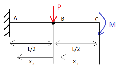

Anyway, here's a beam that I want to solve for deflection of middle point (B) using dummy force P:
And here's my solution:
$$M(x_{1})=-M$$ $$\frac{\partial M(x_{1})}{\partial P}=0$$ $$M(x_{2})=-M-P \left( \frac{L}{2}+x_{2} \right) $$ $$\frac{\partial M(x_{2})}{\partial P}=-\frac{L}{2}-x_{2}$$ $$y_{B}=\frac{1}{EI}\int_{0}^{\frac{L}{2}} M(x) \cdot \frac{\partial M(x)}{\partial P}dx=\frac{1}{EI}\int_{0}^{\frac{L}{2}} \left( -M-P \left( \frac{L}{2}+x_{2} \right) \right) \cdot \left( - \frac{L}{2} - x_{2} \right) dx_{2} = \frac{1}{EI} \int_{0}^{\frac{L}{2}} -M \cdot \left( - \frac{L}{2}-x_{2} \right) dx_{2}=\frac{3L^{2}M}{8EI}$$
It seems fine but I solved an exemplary case and used FEA to find reference solution. This way I found out that my formula obtained from Castigliano's method is not correct. Do you have an idea what's wrong here ?

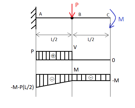

Thanks for reply. I think that the bending moment and shear force diagrams for this beam should look like that:
To be honest, I suspect that the error is somewhere in these two bending moment functions ##M(x_{1})## and ##M(x_{2})##. I omitted support reactions but I guess it's correct. Anyway, something may be wrong in the second function.
I ignore shear forces in Castigliano's method as I only want to account for flexural strain energy.
P.S. In the thread that you've cited different method was used. I want to utilize Castigliano's theorem as this is what I'm trying to learn but of course another method may provide correct solution which would be fairly helpful.
Ok, it seems that I've found an error - as I suspected that second bending moment function was incorrect. It should be ##M(x_{2})=-M-P \left( \frac{L}{2} + x_{2} \right)##. When you solve the rest with this corrected term the result will be ##y_{B}=\frac{0.125M L^{2}}{EI}=\frac{ML^{2}}{8EI}##. Now the results agree with FEA solution.
