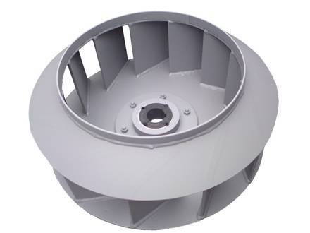

Where does this force go? if the centripetal force goes inwards, am i right to assume the force of 160000 N will be on the hub of the impeller? In no way am i trying to argue with you but i just can't comprehend this, am i thinking wrong?
What's a fan impeller? If it's a small mass located at the tip of the rotating fan, then there's a centripetal force acting on it as you calculated (but check your arithmetic).
this is an impeller.
checked my equation lol yes it was wrong, it should be 598130 N.
does this force go to the hub of the impeller?
It goes through the plates supporting the blades to the hub as tenstion, but assuming the fan is balanced, it doesn't create any radial force on the hub bearing.

Turv said:
radial force on the bearings
I meant due to rotation. If the fan is oriented horizontally, then gravity produces a side load on the beariing, but not a radial load.
