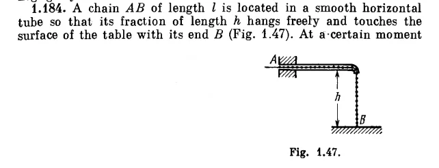

The question is from Irodov Q 1.184. See the Screenshot.
I'm trying to solve it using energy conservation. My thinking is that since all the surfaces are frictionless and only conservative gravitational force is acting, therefore, ME must be conserved.

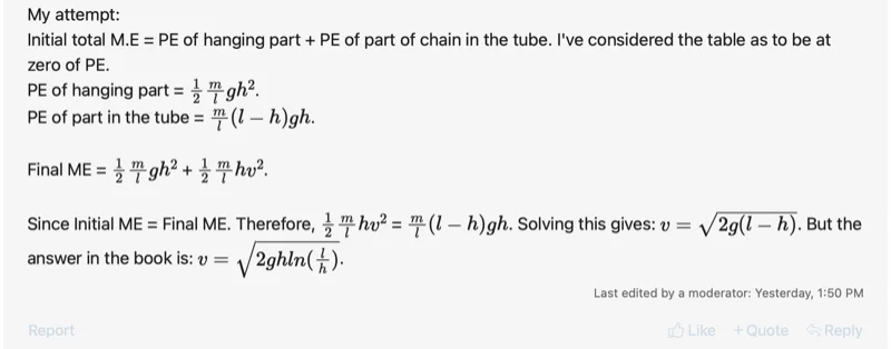

My attempt:
Initial total M.E = PE of hanging part + PE of part of chain in the tube. I've considered the table as to be at zero of PE.
PE of hanging part = ##\frac{1}{2} \frac{m}{l}gh^{2}##.
PE of part in the tube = ##\frac{m}{l}(l - h)gh##.
Final ME = ##\frac{1}{2}\frac{m}{l}gh^{2}## + ##\frac{1}{2}\frac{m}{l}hv^{2}##.
Since Initial ME = Final ME. Therefore, ##\frac{1}{2}\frac{m}{l}hv^{2}## = ##\frac{m}{l}(l-h)gh##. Solving this gives: ## v = \sqrt{2g(l-h)}##. But the answer in the book is: ##v = \sqrt{2ghln(\frac{l}{h})}##.

Homework Statement: The question is from Irodov Q 1.184. See the Screenshot.
@NTesla, the last part of the question on the screenshot is missing. So here’s what (I believe) it should say:
"... At a certain moment, end-A of the chain is released. What is the speed of end-A when it reaches the right-hand end of the tube?"
Are you sure about that? Suppose the whole chain, not just part of the chain, had reached the floor and come to rest. What would the final ME be? If it is different to the initial ME, how do you account for this difference?
Yes, thanks. Edited. The missing screenshot has been added in the original post.
Yes, that's a valid point.

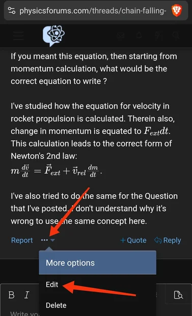

All the equations that I had written have been deleted by the moderator. I don't understand why. Is that just because ##\ln## was not written as it should have been ?
Do you mean the equations from your Post #1? I can see them. Here's a copy, though LaTeX rendering may be a problem:

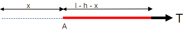

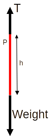

Here's how I'm trying to solve it, using Newton's 2nd law.
I'm considering the whole chain as the system. Let at any instant of time, t, the horizontal part of the chain is x distance from the left end. ##v## is the velocity of the chain at the instant t. ##\lambda## is the mass per unit length.
## \Delta\vec{P} = \vec{P_{f}} - \vec{P_{i}}##
##\vec{P_{i}} = \lambda (l - x - h)v\hat{i} - \lambda hv\hat{j}##
##\vec{P_{f}} = \lambda (l - (x + \Delta{x}) - h)(v + \Delta{v}) \hat{i} - \lambda h(v + \Delta{v}) \hat{j}##
This gives in the ##\hat{i}## direction: ## \Delta\vec{P} = \lambda\left ( (l - x - h)\Delta{v} - \Delta{x}v \right )\hat{i} ##. (ignoring ##\Delta{x}\Delta{v}##).
Now, in the ##\hat{i}## direction, the force is due to the weight of the hanging part of the chain, which is constant, as long as x ranges from 0 to ##(l-h)## and that force is = ##\lambda hg##.
From here, the differential equation in the limit ##\Delta{t} ## tends to 0, gives: $$(l - x - h)\frac{dv}{dt} - v^{2} = hg$$.
But solving this differential equation is not giving the right answer. I'm dont know where I'm going wrong.
my version is
$$\ddot x=-\frac{gh}{x+h},$$
where ##x## is a length of the horizontal tail

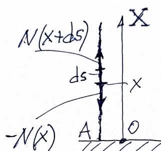

NTesla:
Consider the vertical part of the chain. Let ##N(x)## be a tension force that acts in the section that lies at the height ##x##. For an infinitesimal chain's interval of length ##ds## write down the 2nd Newton:
$$\rho ds a=-g\rho ds+N(x+ds)-N(x)=-g\rho ds+N'(x)ds+o(ds),$$ here ##\rho## is a density of the chain; ##a## is an acceleration.
Thus we have
$$\rho a=N'(x)-g\rho.$$
Take the integral ##\int_0^h dx## from the both sides of this equality
$$\rho a h=N(h)-N(0)-g\rho h,\quad N(0)=0.$$
Do the same for the horizontal part of the chain.

wrobel said:
NTesla:
Thus we have
I'm trying to understand your solution. Could you kindly tell me what does the last term ##o(ds)## mean, and where did that come from. I understood till the term ##N'(x)ds##.
Secondly, by simplifying the equation: $$\rho a=N'(x)-g\rho.$$, we get:
$$\rho vdv = dN - g\rho dx$$. LHS of this can be integrated for some values of v, but you've mentioned to use ##\int_0^h dx## on both sides of this equation. This part I dont understand. Kindly explain.

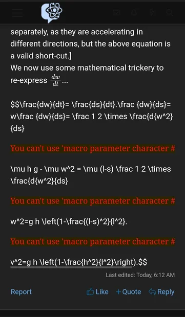

This is a re-write of my original post – of which I am ashamed.
Mechanical energy is lost, because of the inelastic collision between the chain and the floor. This makes it unlikely that methods based on energy will be of any use. This prediction is confirmed by the form of the answer.
Instead we apply ##F=ma## to the moving part of the chain... Suppose that when length ##s## has hit the deck, the rest of the chain is moving at speed ##w##. Writing ##\mu=\frac m l##, the mass per unit length of chain, we have
$$\mu h g = \mu (l-s) \frac{dw}{dt}$$
[Strictly the part of the chain in still in the tube and the vertical parts ought to be treated separately, as they are accelerating in different directions, but the above equation is a valid short-cut.]
We now use some mathematical trickery to re-express ##\frac{dw}{dt}##...
$$\frac{dw}{dt} = \frac{ds}{dt} \frac {dw}{ds} = w \frac {dw}{ds} = \tfrac 1 2 \frac{d{w^2}}{ds}$$
So our ##F=ma## equation becomes
$$\mu h g = \mu (l-s) \times \tfrac 1 2 \frac{d{w^2}}{ds}$$
Separating variables, integrating and Imposing the initial condition ##w=0## when ##s=0##, and the 'final' condition, ##w=v## when ##s=l-h##, we obtain the answer in your book.

How do I make the latex delimiters spring into action?
