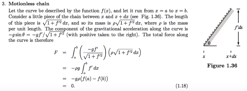

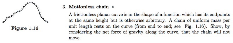

Let ##\vec{a}## be the gravitational acceleration along the curve.
Then ##|\vec{a}|=a=-g\sin\theta## and
##\vec{a}=a_x\,\vec{i}+a_y\,\vec{j}=-g\sin\theta\cos\theta\,\vec{i}-g\sin^2\theta\,\vec{j}##
My question is why does the solution below ignore the direction of ##\vec{a}## and calculate ##F## as ##F=\int a\,dm## instead of calculating ##\vec{F}## as ##\vec{F}=\int a_x\,dm\,\vec{i}+\int a_y\,dm\,\vec{j}##?
Solution:
Can the chain move if its center of mass is not moving? Will the center of mass of the chain move downwards if there is no net vertical force on it? How would you go about calculating that net vertical force?

All you care about is the component of weight tangential to the curve, given by ##g \sin\theta dm##. Any other component will be canceled by the normal force.
By breaking that tangential component into x and y components you are just making it harder to calculate. I haven't tried it, but done properly you should get the same result.
As you said, the net force ##dF## on a mass element ##dm## is ##g\sin\theta\,dm##. But force is a vector. So we should be considering ##\vec{dF}## together with its direction. The direction of ##\vec{dF}## is different for every mass element because the slope of the curve is different in different places in general.
I don't get why the solution treats force as a scalar and calculates ##F=\int dF## instead of ##\vec{F}=\int\vec{dF}=\int dF_x\,\vec{i}+\int dF_y\,\vec{j}##.

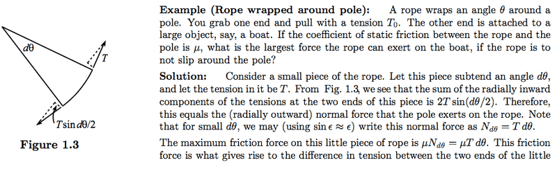

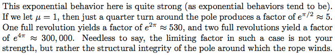

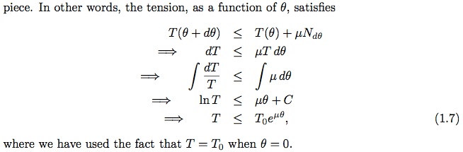

The example below (attached) also treats force, in this case tension, as a scalar instead of as a vector, when it writes the equation
##T(\theta+d\theta)\leq T(\theta)+\mu N_{d\theta}##. --- (1)
I believe the correct equation (considering components in the tangential direction) should be
##T(\theta+d\theta)\cos\frac{d\theta}{2}\leq T(\theta)\cos\frac{d\theta}{2}+\mu N_{d\theta}##. --- (2)
However, since ##d\theta## is small, ##\cos\,d\theta\approx 1##. And so equation (2) reduces to equation (1).
This means that we could "treat force as a scalar" if we consider the tensions between adjacent mass elements.
