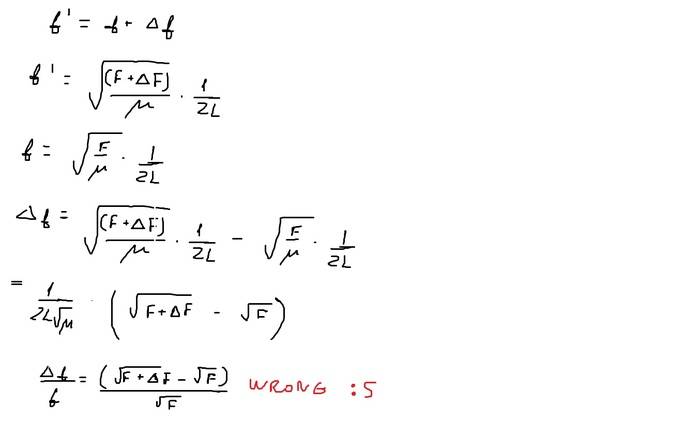

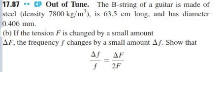

Change in frequency with a small change in tension (guitar string)
The discussion focuses on the relationship between frequency changes and tension adjustments in guitar strings. A participant confirms their solution by validating it with random numbers but struggles to express it as required by the problem. They reference the first terms of the series expansion of the square root function, specifically \(\sqrt{1+x} \approx 1 + x/2\) for small x. A mentor intervenes to clarify the thread title for better context. The conversation highlights the challenge of applying mathematical concepts to practical problems in music theory.

\sqrt{1+x} \approx 1 + x/2 when x \ll 1
ohhh thanks... I see that my answer was correct by checking my last formula with random numbers, but I'm still unable to solve it to get the expression as the problem asks. (sorry my english)
It is the first terms of the series expansion of \sqrt{1+x} close to 1.
