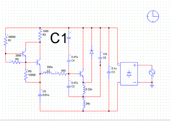

Dear All,
I am designing the circuit for an atomizer. The problem I am facing now is I do not know the method to change the frequency of the voltage applied on the capacitor of my circuit.
Can you provide me some information about the way to change the frequency of the voltage applied on the capacitance C1? C1 is indicated in on the figure attached.
I do not quite know the elements in the circuit which would determine the frequency of the voltage applied on the capacitance of C1.

I don't know either. Can you construct the circuit in such a way that you can experiment before selecting the final chosen value? Why do you want/need to vary the frequency? Do you need to just fine tune it, or might you want to double or triple the frequency?
For tweaking the frequency, I'd try making small changes in any of C5, R1, L3. large changes may cause oscillation to cease or be unreliable.

Thanks for your reply. The capacitor C2 is actually a piezoelectric disk and I am going to use the ultrasonic wave generated by the piezoelectric device to atomize the water. The reaon I want to vary the frequency is that for different piezoelectric disk, the resonant frequency is different.
This circuit is not designed by myself and I just want to copy this circuit board for my own use. So I do not quite understand the working principles of this circuit design. What I want to do is to change the frequency of C1 to change the resonant frequency of the piezoelectric device.
If you can find the source of the circuit, then perhaps we can find there some clues to the way the circuit functions!
Are you an electronics student? If so, perhaps you could model the circuit in SPICE and investigate it there? The frequency may be dependent on supply voltage, so that might be another way to vary the frequency a little. I can see the need to be able to tweak the frequency to be resonant with the crystal.
This is a modified Colpitts oscillator. I didn't particularly like this circuit, because experimentation during simulation led to some high voltages (1KV) and instability in oscillation. If you intend to build the circuit, be very - very careful. Those LC combinations produce some nasty shocks, specially if you're connecting directly to AC.
The circuit operation is highly dependent on the piezo. During simulation it only maintained oscillation on an inductive piezo - a capacitive one damped the oscillations.
Any number of factors can change the oscillation frequency; the one that seemed to be more impacting is changing slightly your C4. If C4 was smaller you could add a trimmer in parallel, but at 470nF you may not find a big enough trimmer; so you may need a bit of trial and error.

The odd looking component at the right is probably a bridge rectifier, but it is connected wrongly. The AC should enter it at the left.
This is a thinly disguised version of a Colpitts crystal oscillator and can hardly claim to be original.
I thought circuits couldn't be patented because they will usually work with minor changes to the component values and yet the circuit is visibly different.
The ultrasonic device will oscillate at its resonant frequency, just like a quartz crystal does, so you won't need to drive it at different frequencies.

Kind of an odd question in my mind...because the reactance of a capacitor is controlled BY THE FREQUENCY...not the other way around.
A capacitor's reactance is 1/(JWC)...where W is radians per second or 2*pi*f...f being frequency. So as frequency changes...so does reactance.
However, if you are talking about the resonant frequency...that is set by this equation:
W=1/(√LC)
So the total reactance of all the inductors...multiplied by the total reactance of all the capacitors as seen by the source...take the square root...inverse...and then change to frequency...will determine the resonant frequency.
So in my mind...the FREQUENCY of your source should be your interest. So if you adjust the frequency input...you adjust the reactance of your capacitors and inductors. If you want a resonant frequency at a particular frequency...you will have to set your final capacitance or inductance.
Perhaps I'm not getting the question or the circuit...but I'm pretty sure what I stated is true.
That looks like Pspice btw...simply alter the freqency of your AC voltage source...device on the right side of the circuit with the ~ sympol in it. Altering the frequency of your source will alter the output of your circuit.
Also...like someone else said...that rectifier is odd right to the left of the AC source.

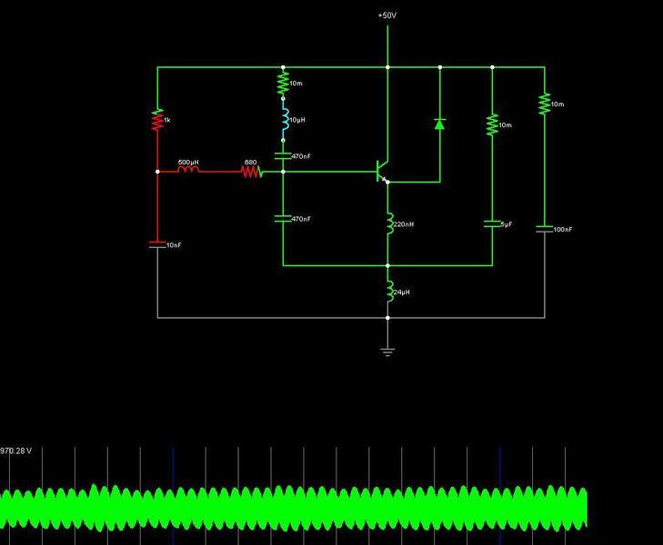

This is an oscillator circuit similar to this one (except it uses a FET) :
The component marked "10M" is a 10 MHz crystal and the circuit will oscillate at 10 MHz and produce a sinewave at the drain of the FET.
This is because the crystal produces a high impedance at its parallel resonance and, at this frequency, feedback from the source to the gate is possible.
The author of the original article apparently found that an ultrasonic resonator will work in the circuit in the patent in post #5. It looks pretty weird, though.
The other components in the circuit have only minor effects on the frequency of oscillation and using a different crystal (or ultrasonic resonator) will result in oscillation at the resonant frequency of that device.

Good. It looks like the power supply would be about 50 volts and the circuit uses a power transistor.
The circuit can be redrawn like this:
http://dl.dropbox.com/u/4222062/Colpitts%20Osc.PNG
because the supply rails are bypassed so that either supply rail is the same as the other for the oscillation frequency.
This is a very conventional Colpitts oscillator.

You ran a simulation and got the impression that huge voltages are produced. You said 1000 volts.
Well, firstly that is not true in real circuits and, secondly, any voltages that are produced vanish pretty quickly when a human touches them.

ps: just so that it's clear where I'm coming from, please read for me the voltage in the inductor in the simulation below. I don't claim the simulation is perfect (I have no idea the characteristics of the transducer he'll use), I only claim that the circuit originally posted can produce high voltages, specially if the poster will try to mess with it.
The patent data you published shows an input AC voltage of 48 volts on page 5, and an output waveform of 75 volts peak (150 volts peak to peak) on page 7.
The choice of input voltage is obviously optional. Another post gave an input voltage of 37 volts, as I recall.
My only interest in this is that you gave a warning based on a simulation where you apparently used an inductor of infinite Q (the 24 μH ) and as a result, got an output of thousands of volts.
Of course you got this result, but it doesn't warrant a general warning about the danger of building this device.
Your circuit doesn't show a transducer. How did you arrive at the substitute components?
I just did a simulation of a pi-network ( 1000 pF to ground, 2 uH in series then 300 pF to ground) and at 6.5 MHz I got a peak of 36000 volts when I fed it with 2 volts across the 1000 pF capacitor.
Adding just 0,1 ohms in series with the inductor brought the output down to 1600 volts and 1 ohm dropped it to 160 volts. So, you have to be skeptical of simulator results like this.
