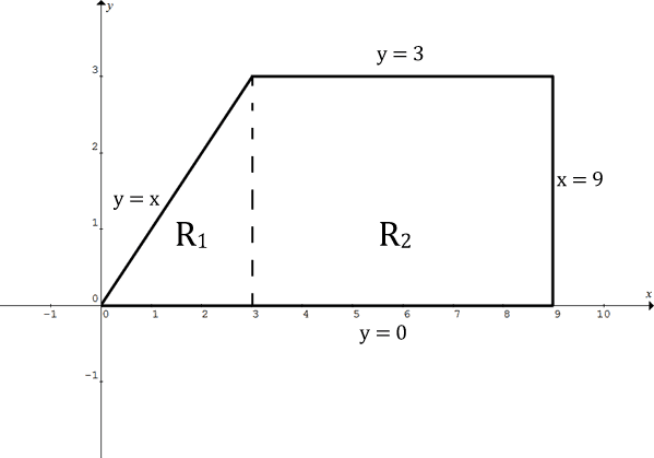

Looks like I'm back with another question already :frown: I need to change the order of integration for this double integral and then evaluate it, but I get to a point where I'm not sure what to do.
[tex]\int^3_{0} \int^9_{y} \sqrt{x}cos(x) dx dy[/tex]
With the changed order of integration it needs two integrals added together, this is what I came up with:
[tex]\int^3_{0} \int^x_{0} \sqrt{x}cos(x) dy dx + \int^9_{3} \int^3_{0} \sqrt{x}cos(x) dy dx[/tex]
And I planned to work them both out separately, but didn't get too far with the first one:
[tex]= \int^3_{0} \left[y\sqrt{x}cos(x)\right]^{x}_{0} dx[/tex]
[tex]= \int^3_{0} x\sqrt{x}cos(x) dx[/tex]
I'm not sure if I've made a mistake getting here, but it looks like I need to integrate [tex]x\sqrt{x}cos(x)[/tex] and there doesn't seem to be an easy way to do that at all.
Hi Refraction! :smile:
Your change of order looks fine.
The only problem is how to integrate x1/2cosx or x3/2cosx … I don't know any way of doing that (other than using power series). :redface:

Hi Refraction,
How did you change the order?(there was a y ?)
For the computation of the integral, the only way I can see is with power series too...
The line was x = y in the original question, I just used it as y = x for when the order is reversed (so it's in the first half of the reversed order integral now).
Well the area bounded by the lines looks something like this:
Coordinate plot of a region split into R1, a triangle bounded by y = x, y = 0 and a dashed line at x = 3, and R2, a rectangle-like region bounded by y = 0, y = 3, x = 3 and x = 9, with boundary lines labelled y = 3, x = 9 and y = 0.
So with the reversed order of integration (dy dx) for the first double integral, R1, the inner integral is from y = 0 to y = x, and the outer integral is from x = 0 to x = 3.
