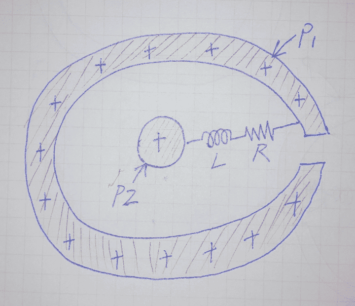

I interpreted the situation as follows. You put charge 2Q by induction (or some other method) on an isolated plate connected to a wire and an open switch. You bring an identical uncharged plate close to the first one. The other end of the second plate is connected to a series RL. You connect the free end of the RL to the free terminal of the open switch. You close the switch and see what happens.

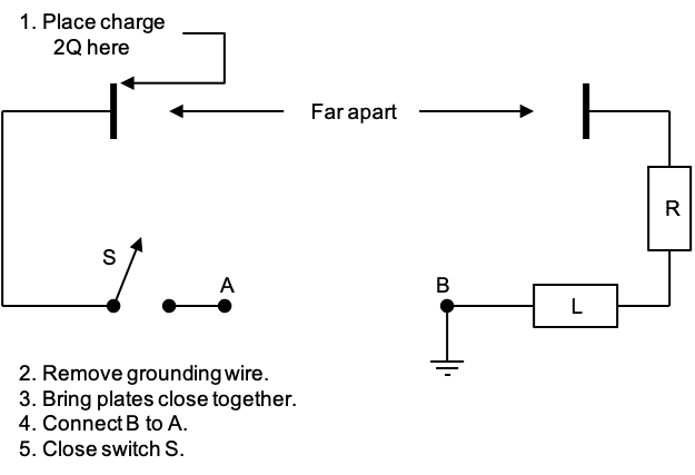

It seems I didn't explain myself well. Here is the schematic.

With this, you should get 2 plates with charge +2Q and -2Q. Use a 3rd, uncharged plate, and bring it near the plate with charge 2Q to form the "+2Q, 0" charge capacitor.
Assuming the 2Q-0 charge capacitor can be made and can be placed in a series RLC circuit, what do you think would be the final charges on the 2 plates?
OK, so this is how I understand your question: A series RLC circuit with a (series) switch is at rest with the switch open. Let's say there is no net charge in the circuit an no charge on either side of the capacitor. Every part of the circuit starts with 0 charge. By some magic process (cosmic ray absorption?) some amount of charge is deposited on each plate, perhaps different amounts. Then the switch is closed and you want to know how much charge is on each capacitor plate after the initial transients have died away to (almost) nothing when you again open the switch*; i.e. steady state. Correct?
As others have said, in steady state the final charge on each plate must be equal. Otherwise there would be a voltage across the cap which would cause the charge to redistribute through the circuit. Also, I'm assuming charge can't leave the circuit and go somewhere else. So the final charge distribution will be half of the (net) added charge on each plate. Or the average value of the initial charge distribution.
So yes, you are correct the final charge for the (2Q,0) initial condition will be (Q,Q).

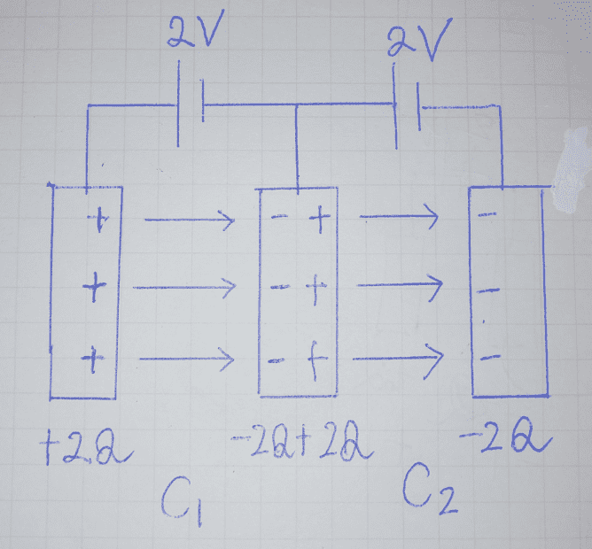

Yes, I think it is not difficult to place any amount of charge on the two plates of the capacitor. For example, we only need to place each plate very close to the ground one by one, and then apply the appropriate voltage between the plate and the ground, so that each plate is charged to the required amount of charge, and then move the two plates close to each other to form a capacitor. Now we can move the capacitor far away from the ground and connect any form of circuit to this capacitor according to our interest.
Of course, this process is to add any amount of charge (positive or negative) on the two plates of the capacitor. As for the final voltage between the two plates of the capacitor, that is another matter.:bear:

The OP is interested in only one plate having charge while the other has zero charge. That is why the plate on the right is grounded. The plate on the right can be charged by induction.

I don't think it is necessary to define the amount of charge of the capacitor as ## ~\frac {Q_{p1}-Q_{p2}} {2}~ ##, and it may cause misunderstanding. Please see the following example of two capacitors in series.
Since the net charge of the middle plate is zero, the charge of C1 may become ##~\frac {+2Q-0Q} {2} =Q ~##, but in fact the charge of C1 should still be regarded as ##2Q##. :smile:

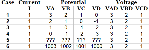

I agree. I've been making that point using other words. In circuit analysis, only voltage differences, not absolute potentials, play a role. I use these figures to illustrate. You can think of case #6 as the one with excess charge in the circuit.
Looking at it another way. One can not combine field theory for how charges distribute themselves in a conductor, with circuit analysis. In circuit analysis, none of the ideal components in the circuit need to be physically realizable. I could replace all the wires, V, R, L, and C in the circuit with digital simulators of wires, V, R, L, or C and the circuit solution would be the same.
